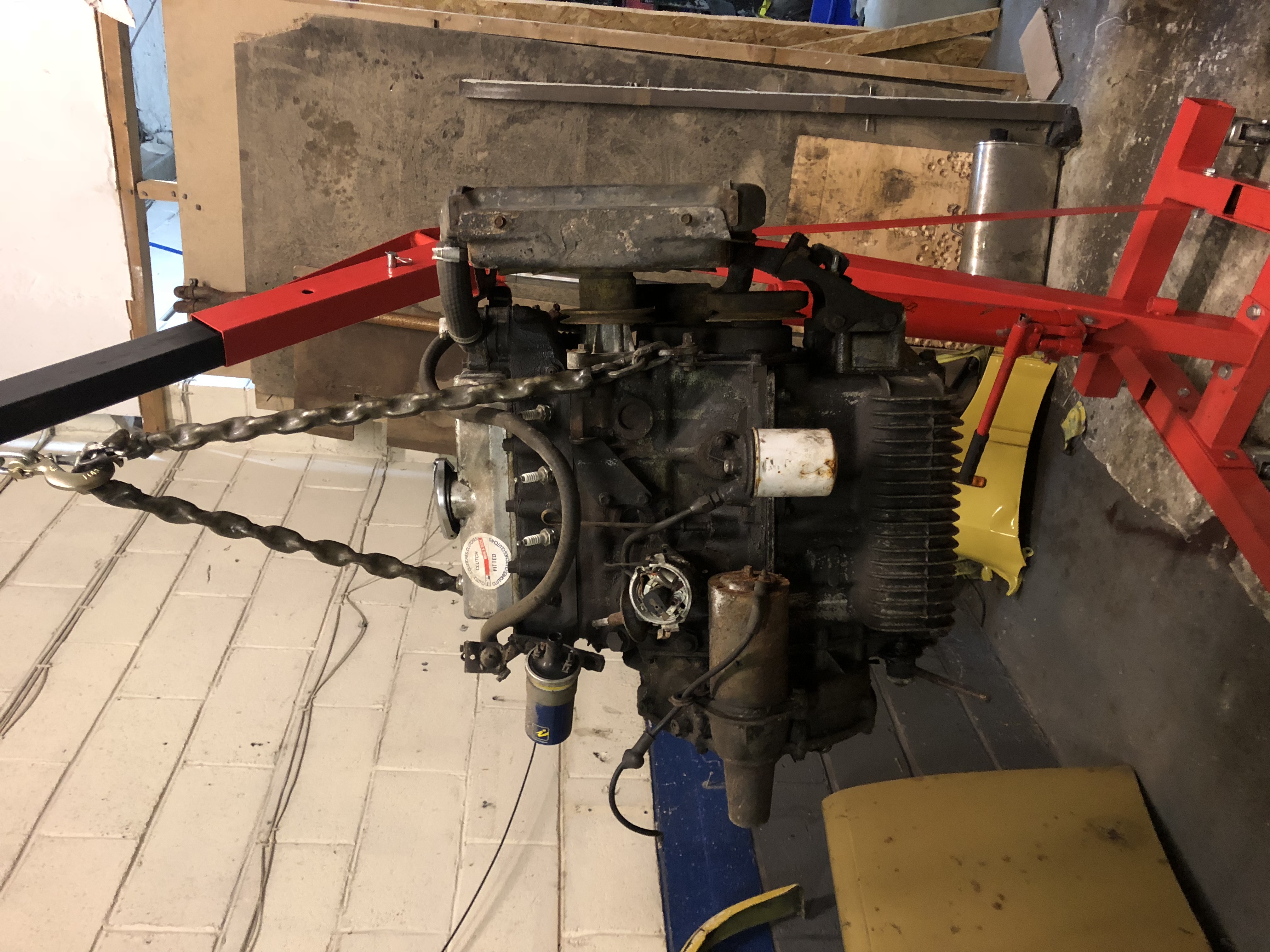

SamKidney Posted November 7, 2019 Report Share Posted November 7, 2019 Quote Link to comment Share on other sites More sharing options...
Tom Booth Posted November 7, 2019 Report Share Posted November 7, 2019 All hail the mighty A series. Quote Link to comment Share on other sites More sharing options...

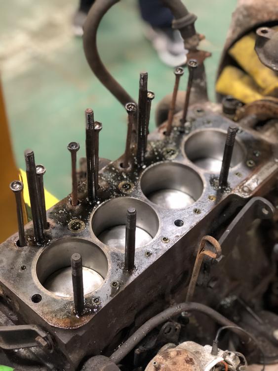

SamKidney Posted November 8, 2019 Report Share Posted November 8, 2019 Just gets better. Pistons are brand new and bores are immaculate. Intrigued to see what cam it has fitted. Quote Link to comment Share on other sites More sharing options...
David Posted November 10, 2019 Report Share Posted November 10, 2019 Shameless plug for my LC: https://www.ebay.co.uk/itm/184030563080 Quote Link to comment Share on other sites More sharing options...
Danny Posted November 11, 2019 Report Share Posted November 11, 2019 On 08/11/2019 at 2:33 PM, SamKidney said: Pistons are brand new and bores are immaculate. Intrigued to see what cam it has fitted. Whats written on the pistons? Has it been rebored at all? Quote Link to comment Share on other sites More sharing options...
SamKidney Posted November 11, 2019 Report Share Posted November 11, 2019 2 hours ago, Danny said: Whats written on the pistons? Has it been rebored at all? They’re stamped +20 It looks to have been re-bored but without measuring them I couldn’t say. Quote Link to comment Share on other sites More sharing options...
