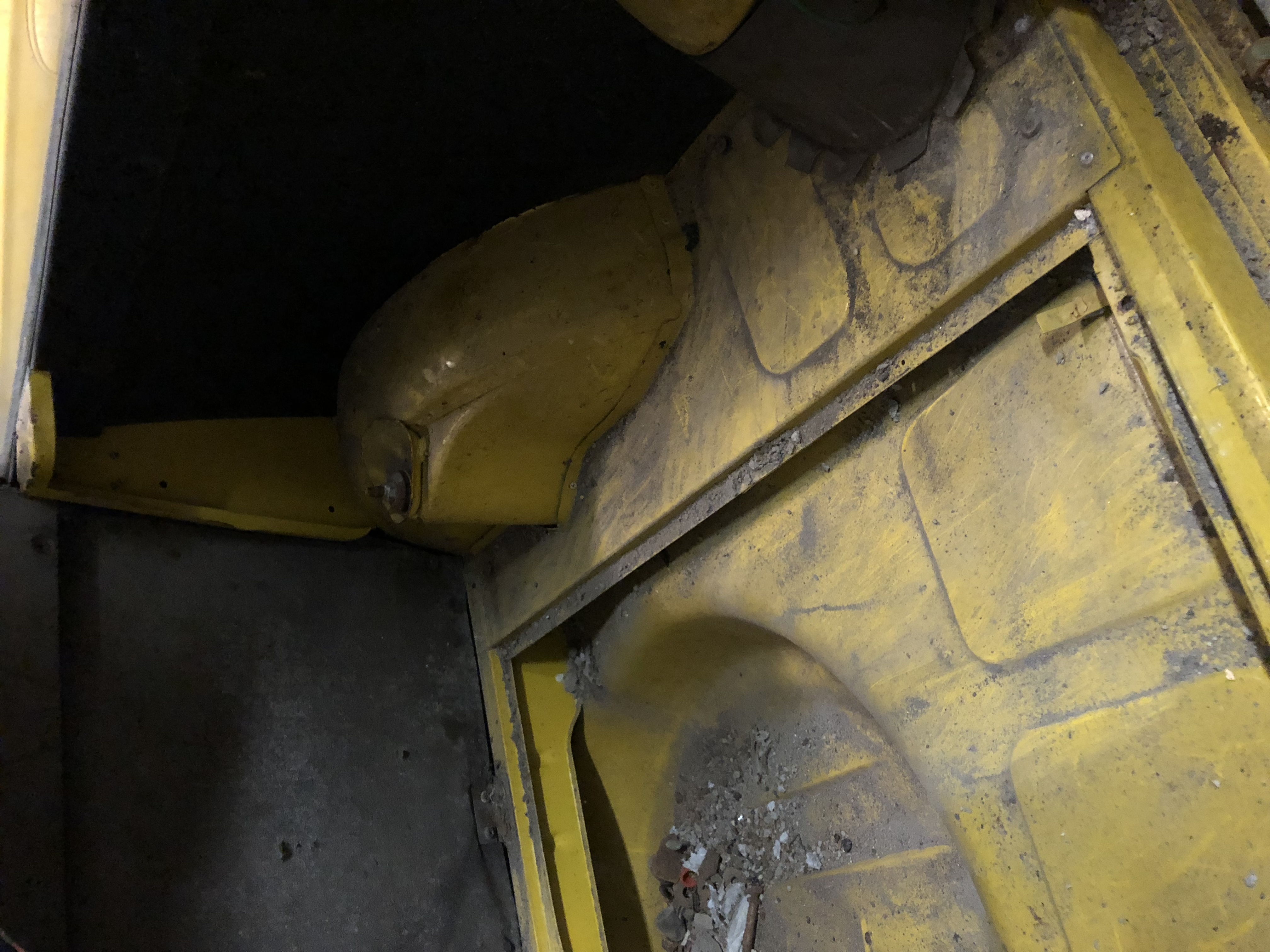

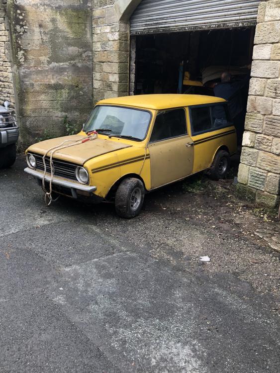

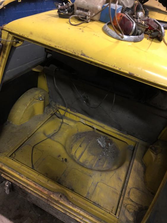

You’ll be pleased to know I’ll be keeping this one as should be mechanically.
It has a 1275cc GT lump fitted that was supposed to have been re-built and had a fancy cam about 20 years ago.. hasn’t run since. I was going to try get it running ASAP but I’ve had a quick nosey under the valve cover and it looks like it could be best to strip/clean/assess and re-assemble before doing so. Carburettor probably isn’t up to the job without a rebuild either.
Really looking forward to getting into it. The shell is fantastic and needs relatively little attention. Subframe/suspension/bushes and ball joints are all still as new.
Started emptying the mini of the parts it came with and had a good prod round it. 50 years old this thing and I’ve had civics in worse condition. Astounding how good the shell is. Inner wings/bulkhead and front panel are all solid, the “boot” looks as if it will come up as new with a good clean. It seems any corrosion that has come about is largely superficial and all on the exterior as a result of it holding water. That said though all the gutters around the roof are solid with any corrosion being surface. Amazed.
  • Like 2
