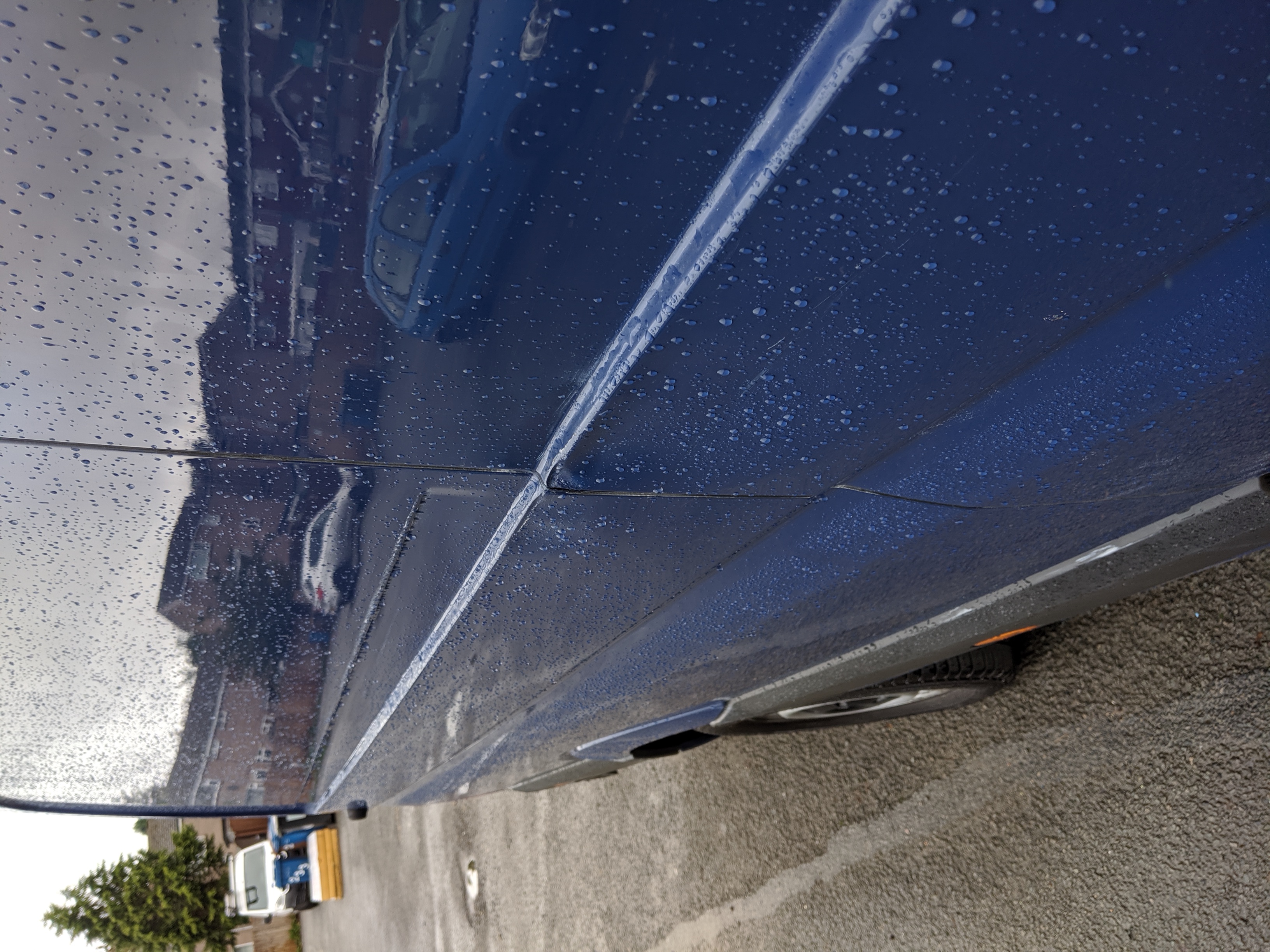

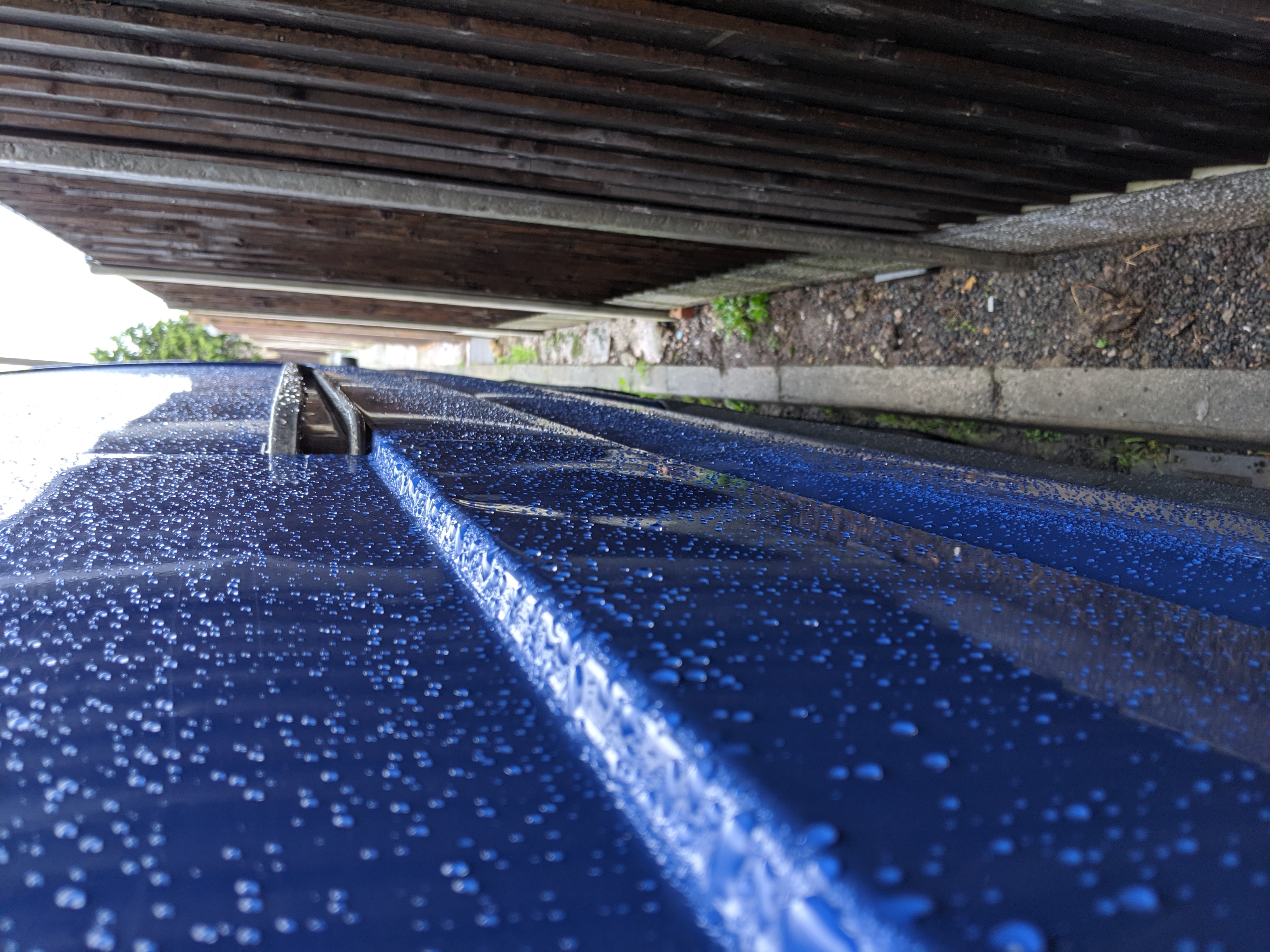

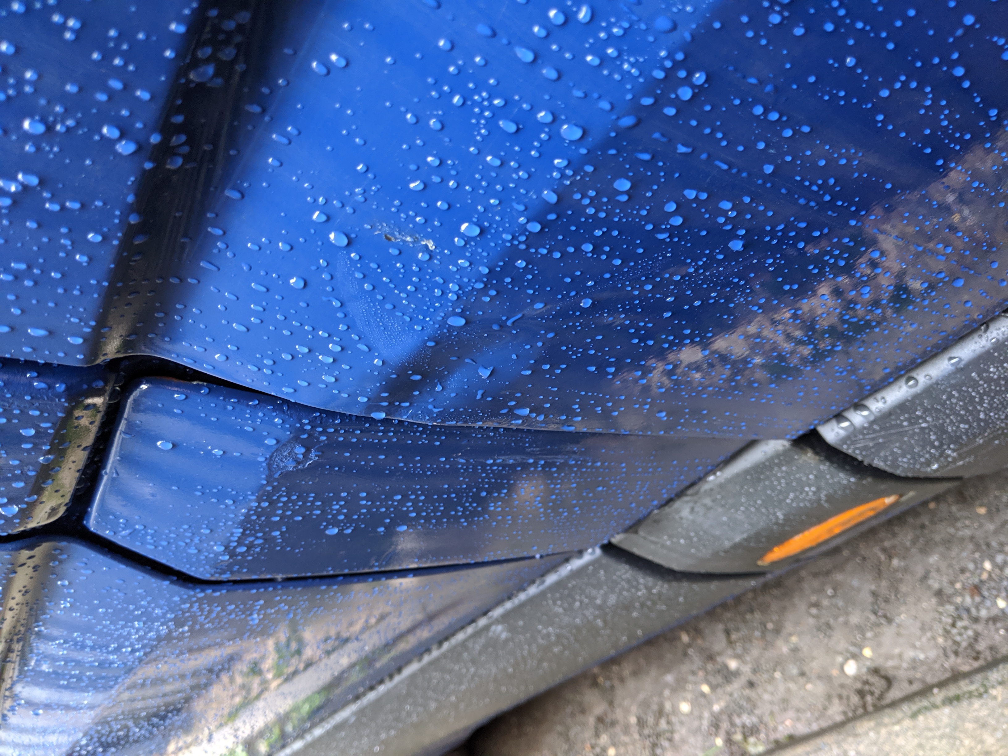

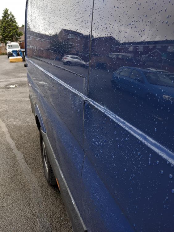

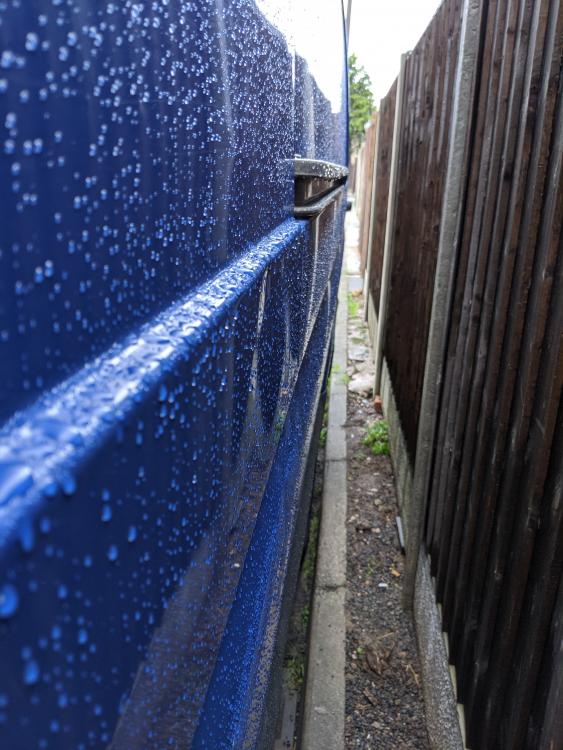

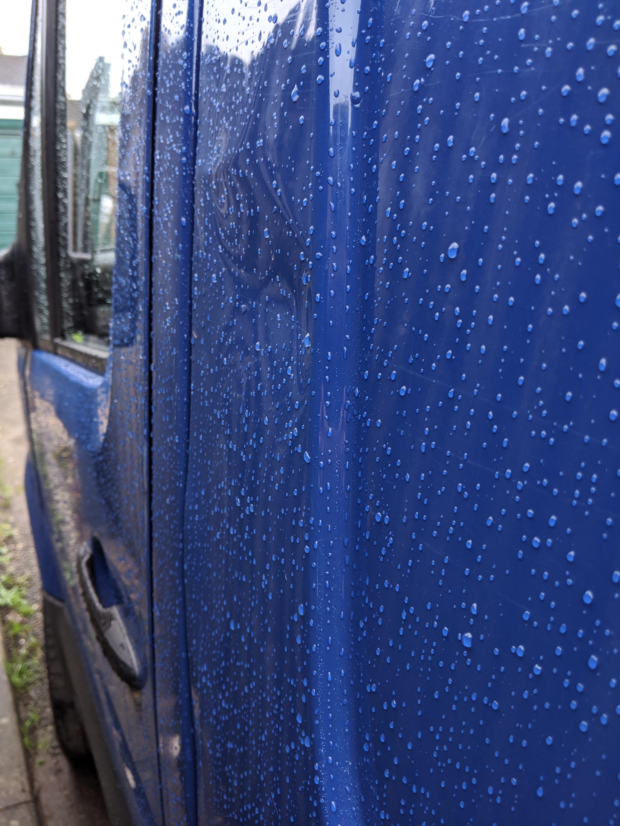

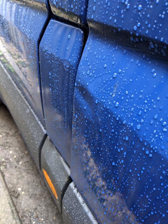

Pictures are in order:-
Back half of the door, accessible from inside so should push out fine with some tapping.
Front edge of door by filler cap, blind so no tapping it out, think this is likely a filler dent.
Front edge of the door partially accessible by removing the internal door handle so might tap out ok.
Offside dent on a seam, think it's been previously cleaned up a little but needs attention as the paint is cracked. Not accessible as it's on an internal rib.

I think 1 if your careful you could make that look respectable from the inside, be careful what you push that put with though, you may find the end result will be worse then what you have now.
The others I'd look at any form of slide puller with attachments small enough to get in there. I've had more success with smaller dents on panels then large as I think theres less stretch o shrinkage in them.
