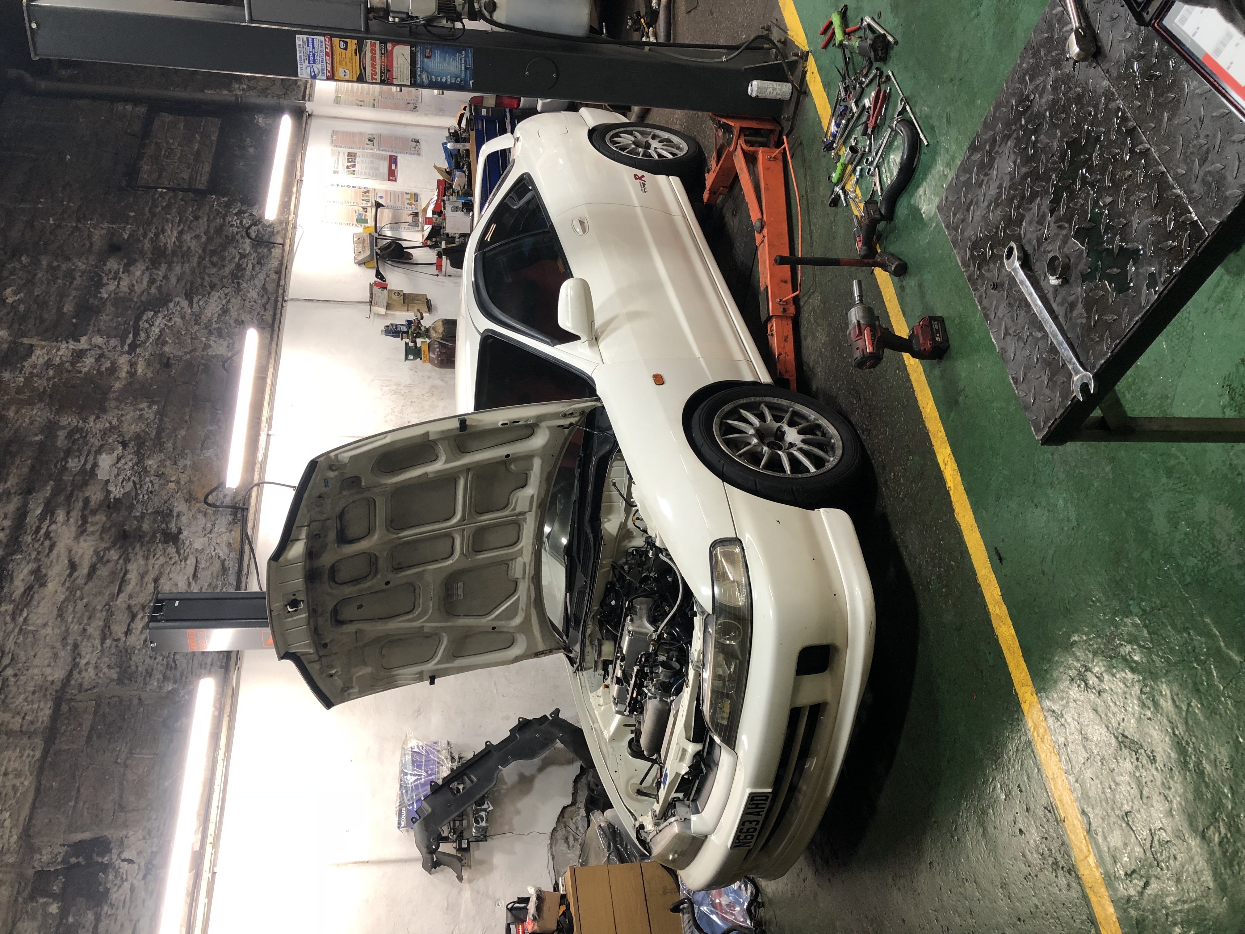

SamKidney Posted August 16, 2019 Report Share Posted August 16, 2019 54 minutes ago, Luke Rainbird said: Awesome! Stoked or you dude - k24 turbo next? Cheers! My EK9 shell is having the k24 with a view to being my “racecar” in 2021. DC2 is having a K20 with compliant suspension and an LSD so I can enjoy it as a road car Quote Link to comment Share on other sites More sharing options...
Luke Rainbird Posted August 16, 2019 Report Share Posted August 16, 2019 That's far too sensible Quote Link to comment Share on other sites More sharing options...
SamKidney Posted August 16, 2019 Report Share Posted August 16, 2019 5 hours ago, Luke Rainbird said: That's far too sensible Sensible but allows me to enjoy a DC2 close to as it should be, but with my preferred power plant Quote Link to comment Share on other sites More sharing options...

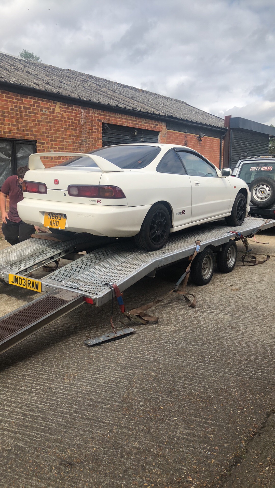

SamKidney Posted September 9, 2019 Report Share Posted September 9, 2019 One Integra Type R in my possession Engine mounts in, rad mocked up. One or two more bits to aquire and I can get the 24 in and running. 3 Quote Link to comment Share on other sites More sharing options...
Luke Rainbird Posted September 9, 2019 Report Share Posted September 9, 2019 So much love for that! Quote Link to comment Share on other sites More sharing options...

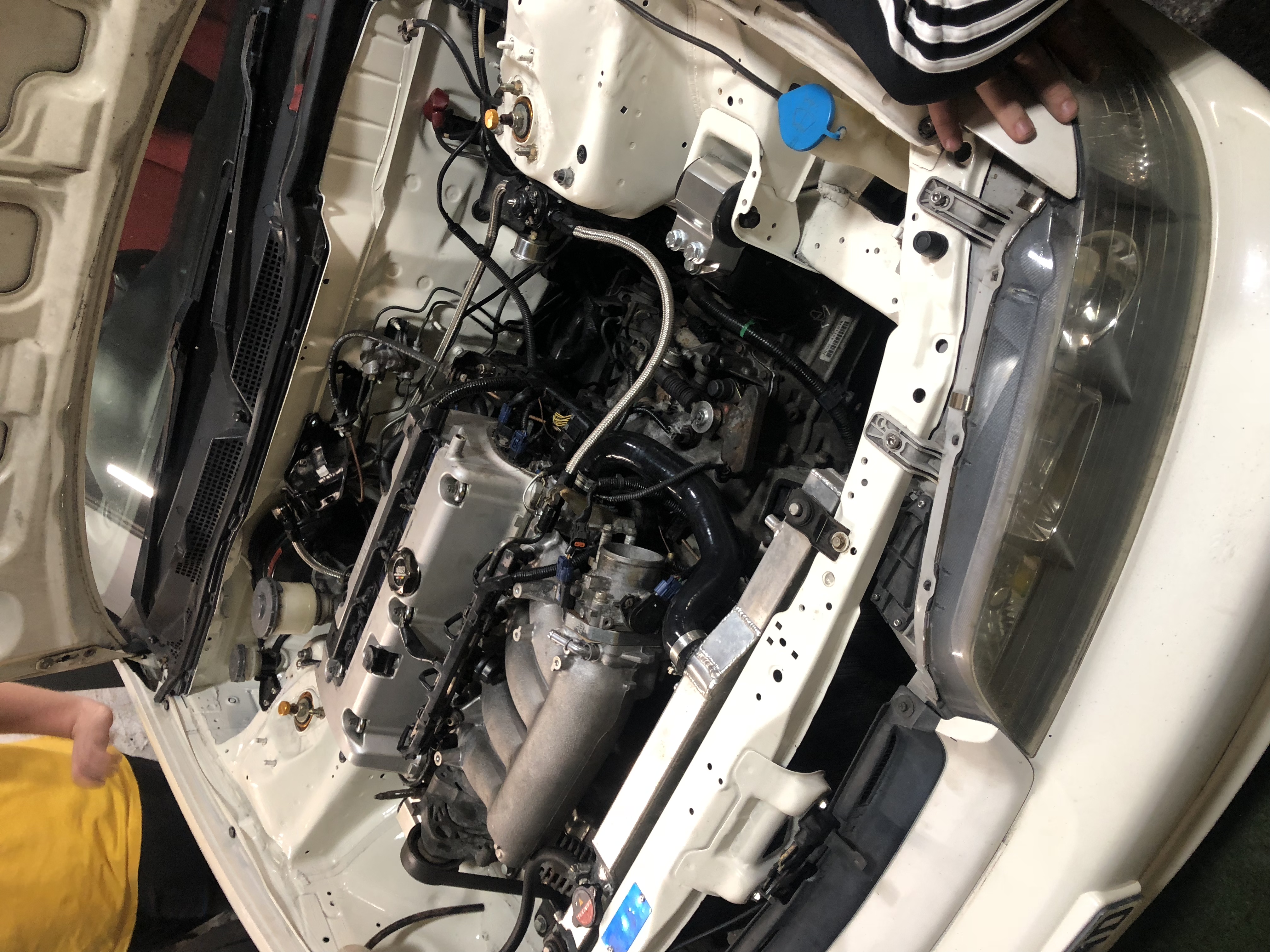

SamKidney Posted September 14, 2019 Report Share Posted September 14, 2019 Progress. Fluids, exhaust and some wiring to sort tomorrow/today and I can take it for a spin! Quote Link to comment Share on other sites More sharing options...
dann2707 Posted September 16, 2019 Report Share Posted September 16, 2019 Jealous of how much room you have for that inlet. I have to hack away at my firewall to fit my rbc manifold haha Quote Link to comment Share on other sites More sharing options...

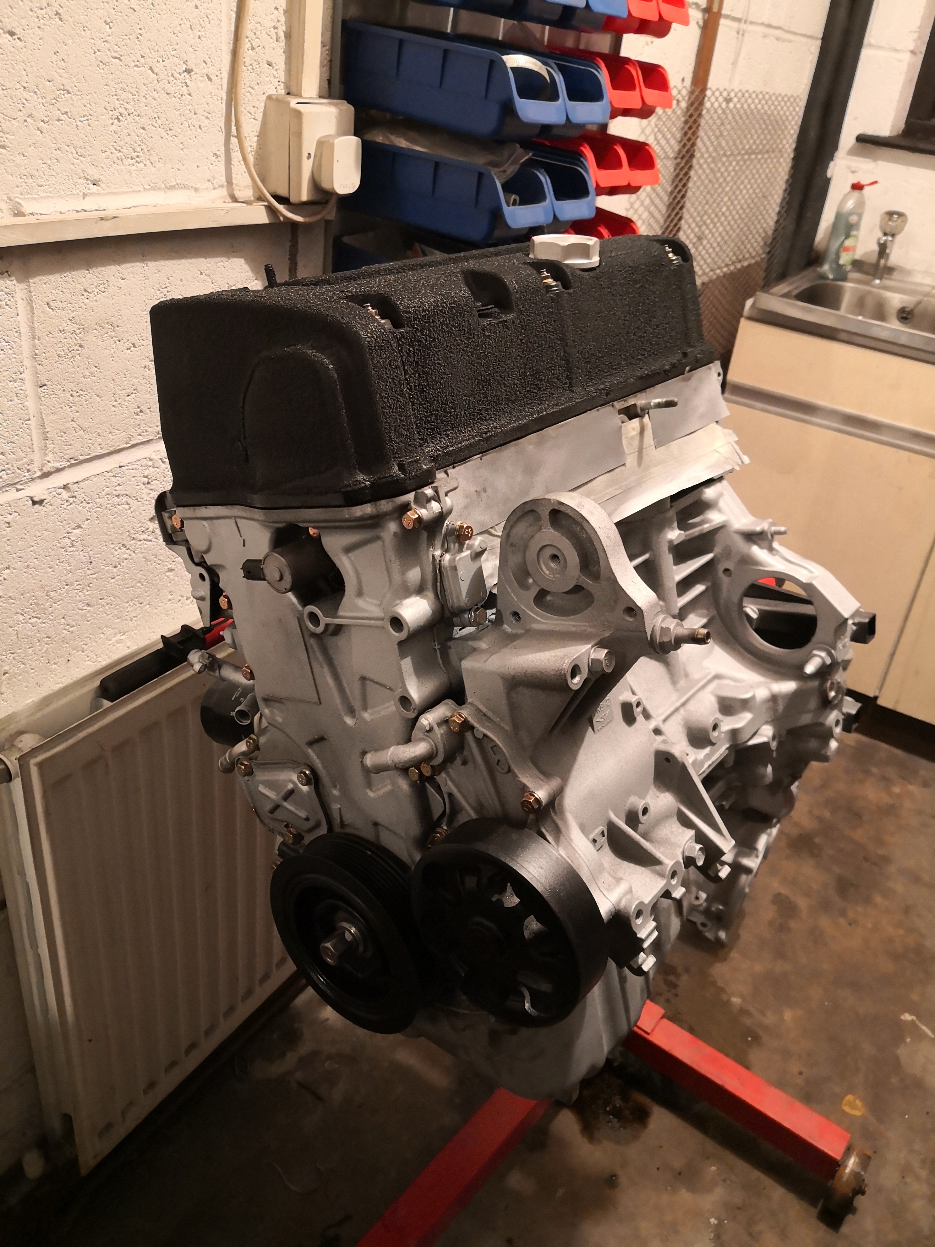

dann2707 Posted September 24, 2019 Report Share Posted September 24, 2019 Should do a big update on the mr2 k20 build soon. Basically the engine is having a full nut and bolt resto with the box that's having an Lsd fitted, re assembled that I finished last night Quote Link to comment Share on other sites More sharing options...
AdamR28 Posted September 24, 2019 Report Share Posted September 24, 2019 Sounds interesting, seen a few MR2s with that lump in and they seem very well matched! Quote Link to comment Share on other sites More sharing options...
dann2707 Posted September 24, 2019 Report Share Posted September 24, 2019 Definitely seem to go very well once set up properly. I'll be making my own exhaust manifold and exhaust from scratch which should be awesome. Just received the k20 flange through the post. Exciting times. 1 Quote Link to comment Share on other sites More sharing options...
