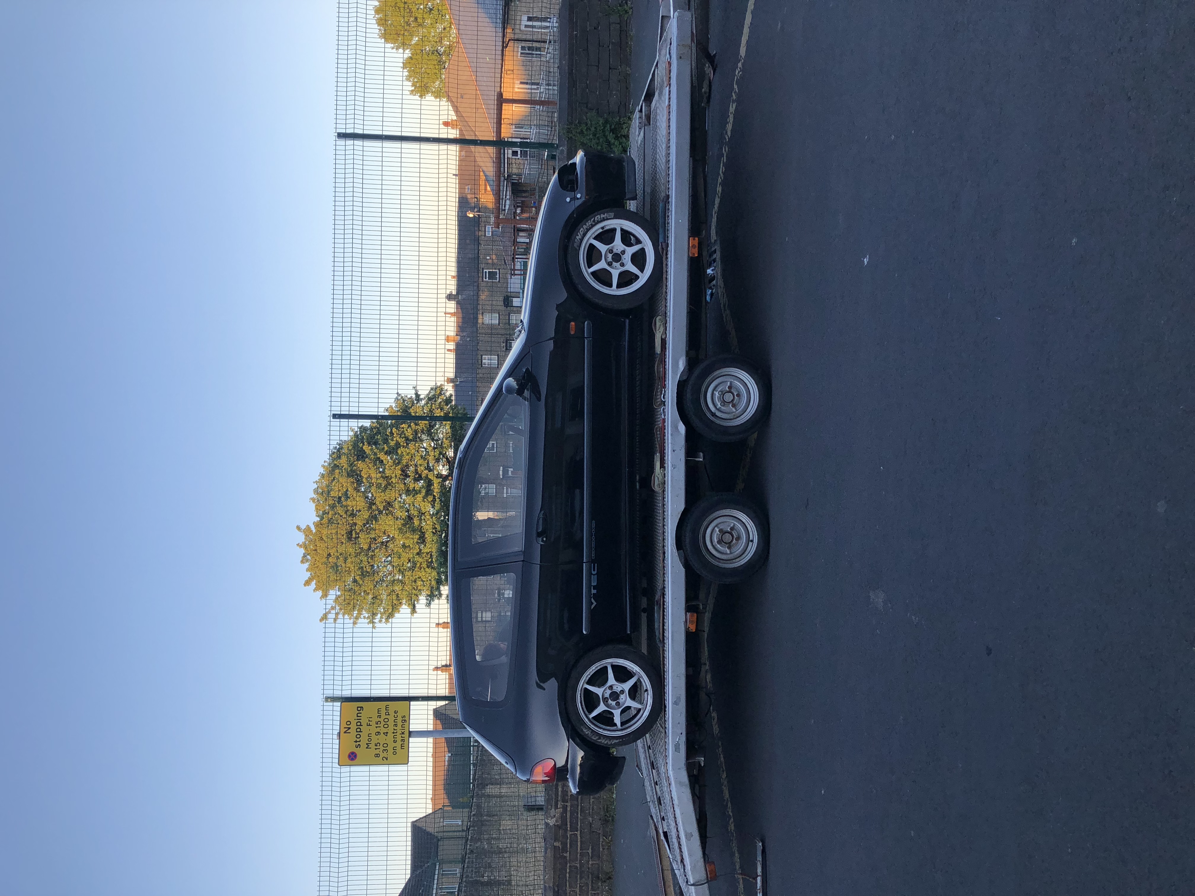

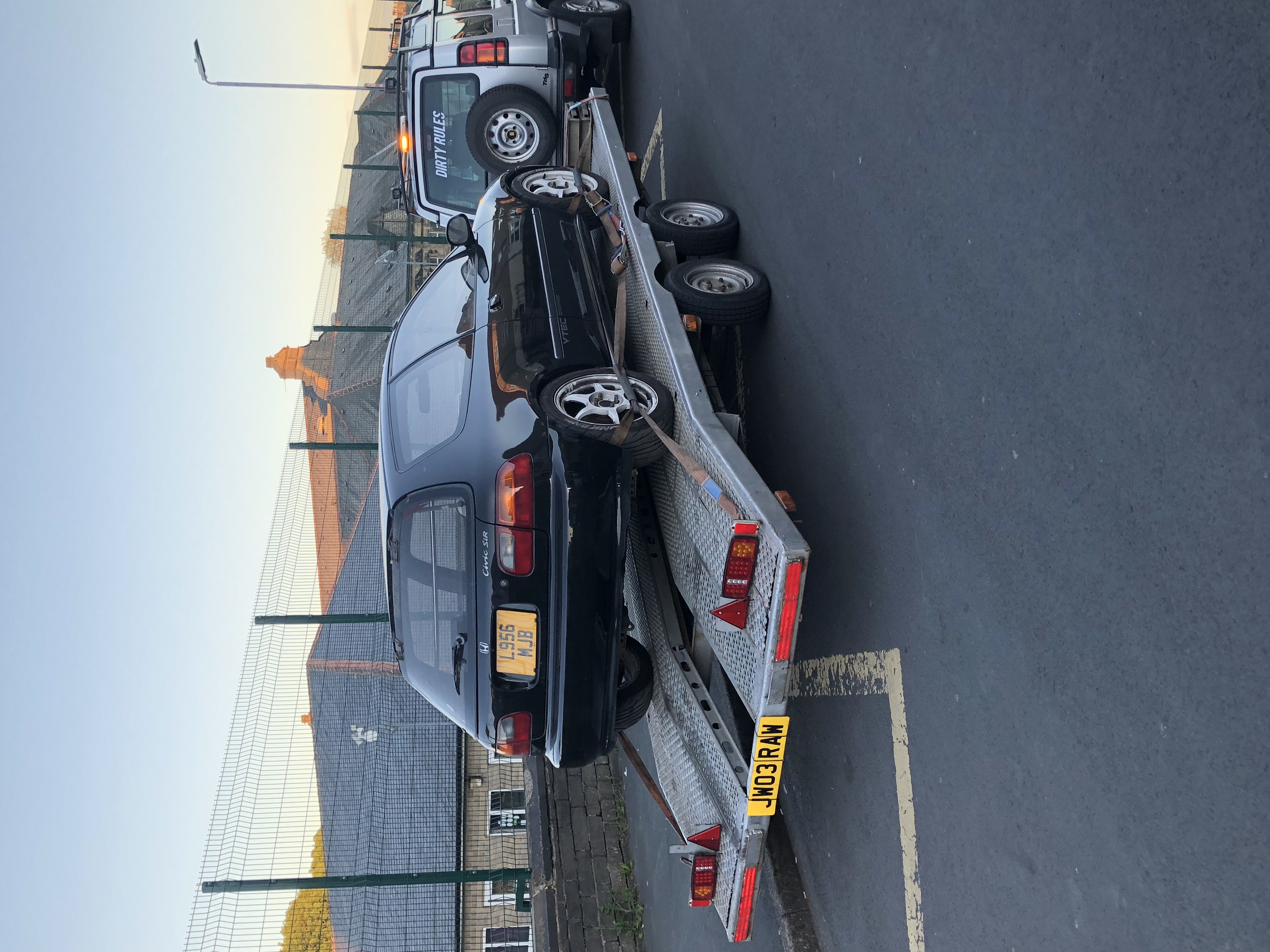

Anyway... yeah, my BMW has just been loaded on to a truck because of a wheel bearing too. BMW don't class that as a mechanical failure, so I don't have any sort of replacement vehicle. That's fine, I'll just work from home indefinitely because all workshops are booked up until the end of June.
Shitty customer service.
I've had noisy bearings with no play in the past too. Usually if you hold the suspension spring and spin the wheel you can feel the roughness in the bearing amplified by the springs wobblyness when you can't feel it otherwise. Could be worth a go before messing around with gearboxes.
I've had rears sound like fronts and left's sound like rights etc too, so check all 4 before ruling them out.
Ah Mike, that's a PITA to say the least. Hopefully they take the nudge and step it up a notch for you.
