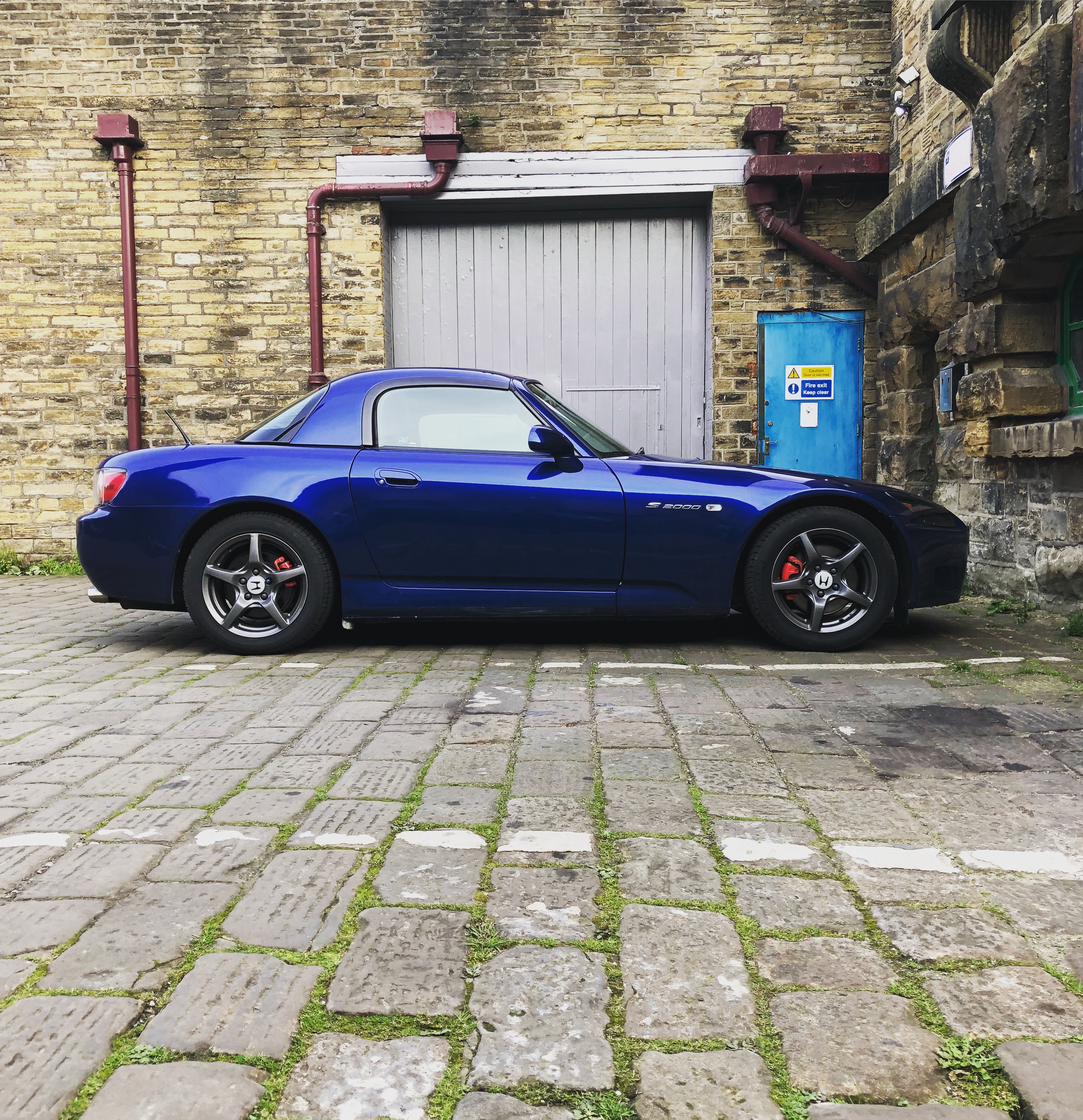

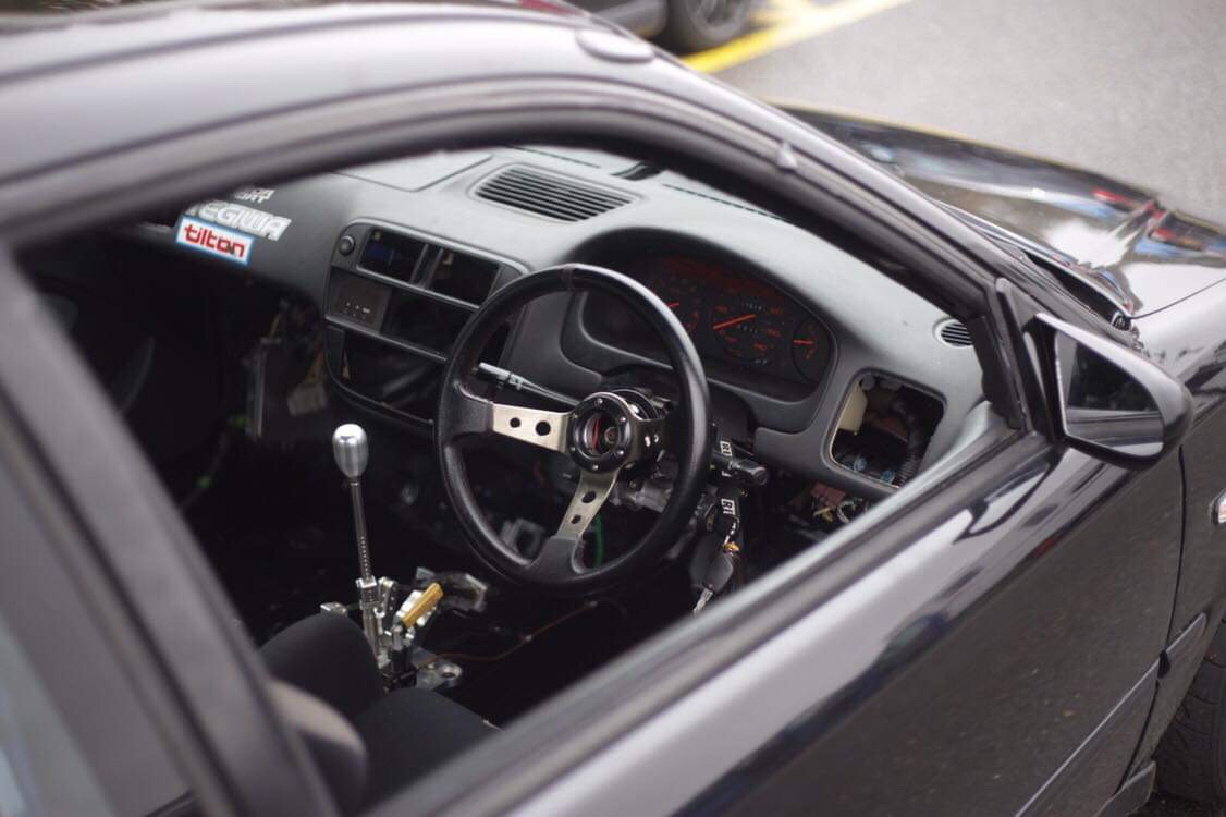

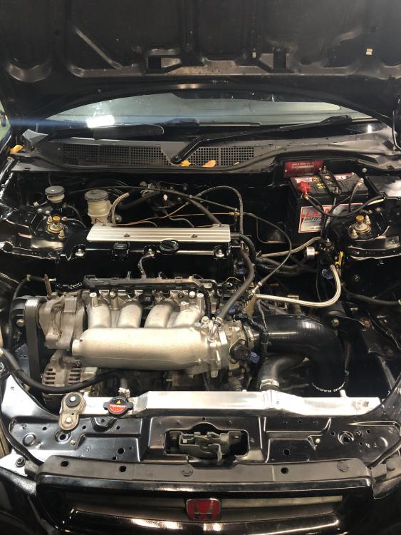

SamKidney Posted September 26, 2018 Report Share Posted September 26, 2018 (edited) S2000 and a cleannnnn EK hatch in for some electrical gremlins sorting this week. S2000 was a simple misfire though the fans are running all the time even when cold. Suspected fan switch on thermostat housing. Civic has just been painted, and now won’t run.. lack of decent/clean earths is my first thought. EP3 Type R in tonight for a VTC gear change, and should have another Civic EK coming in to complete an abandoned K20 conversion. Been quiet the last few weeks but it’s good to have the book filling up again. Edited September 26, 2018 by SamKidney 3 Quote Link to comment Share on other sites More sharing options...
