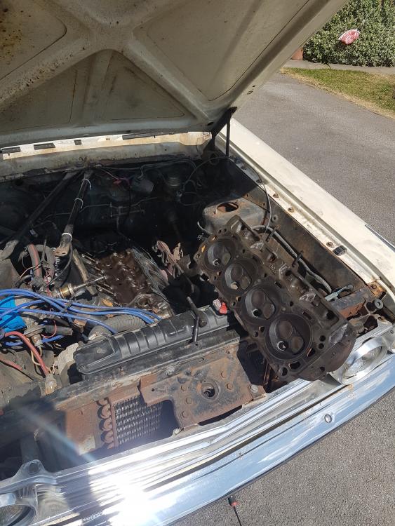

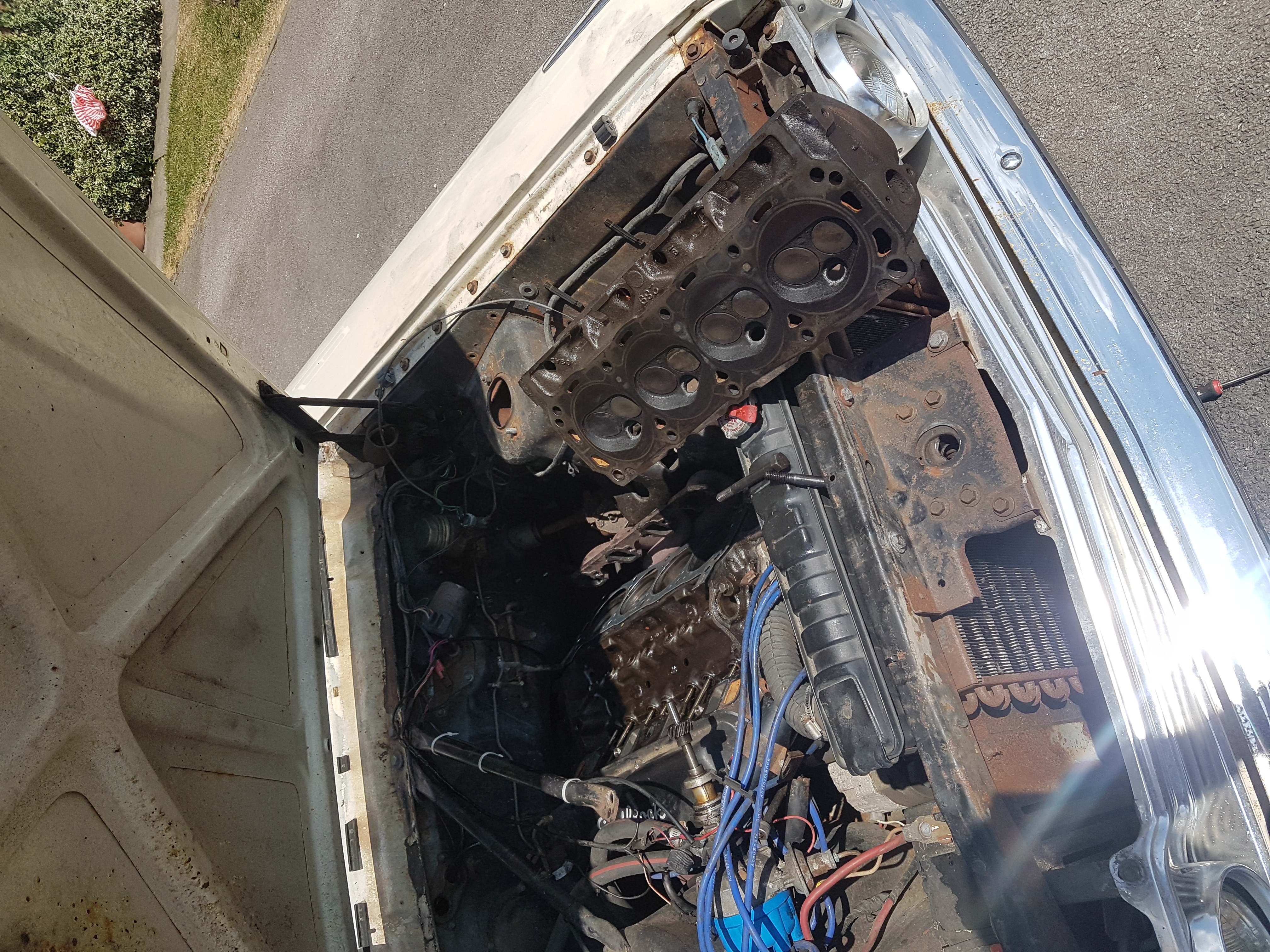

Tom Booth Posted July 7, 2018 Report Share Posted July 7, 2018 Heady gasket done... Been a run around the block and it has a huge air leak somewhere. I don't think the inlet has sealed to the heads so I'll whip it off tomorow and get some RTV round it too. Casualty - one back where t shirt and shorts didn't meet.. Quote Link to comment Share on other sites More sharing options...

Tom Booth Posted July 8, 2018 Report Share Posted July 8, 2018 18 hours ago, Tom Booth said: Heady gasket done... Been a run around the block and it has a huge air leak somewhere. I don't think the inlet has sealed to the heads so I'll whip it off tomorow and get some RTV round it too. Found it... Took the inlet off and decided to do it right so took the carb off to get to all the bolts torqued properly and in order. Noticed when I'd took the carb off there was 2 vacuum take off blanking bullets that were bone dry and cracked - found the leak... Replaced with folded over rubber hose filled with rtv paste. New hoses throughout too and it's great. Runs like a beauty and goes like a train. Sounds fantastic too! Don't think it's ever been right so it's a pleasant surprise! 1 Quote Link to comment Share on other sites More sharing options...
