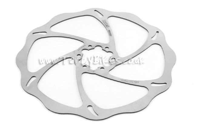

Sam Song Posted April 13, 2012 Author Report Share Posted April 13, 2012 Hopes are fine long-term if you look after them/ have some mechanical knowledge. Have you ever owned one or is this just based on forum hearsay? Until 2 months a go or so i was running a Mono Trial that was 6 years old and it was spot on, only changed because a Tech came up for a decent price. Yup I have a hope trials that I'm not quite happy with. Modulation is good, but no locking power... I'll try the saint and see how it works out, but since I do not like centerlock shimano disks, Hope saw disk works with Shimano saint right? http://www.tartybikes.co.uk/disc_brake_rotors/hope_saw/c76p10156.html Quote Link to comment Share on other sites More sharing options...
Laurence--Trials Posted April 13, 2012 Report Share Posted April 13, 2012 (edited) Yup I have a hope trials that I'm not quite happy with. Modulation is good, but no locking power... I'll try the saint and see how it works out, but since I do not like centerlock shimano disks, Hope saw disk works with Shimano saint right? http://www.tartybikes.co.uk/disc_brake_rotors/hope_saw/c76p10156.html Any disc works with any brake. Its just the hub type thats different. Saints are really good, the only thing im not that keen on is the fact that if you pull the lever a few times the bite point will get further away then if you leave it for a few seconds it'll go back to where it originally was. They're also a similar weight to hopes at 340g each W/O mounting stuff or rotors. Edited April 13, 2012 by Laurence--Trials Quote Link to comment Share on other sites More sharing options...

Sam Song Posted April 15, 2012 Author Report Share Posted April 15, 2012 Any disc works with any brake. Its just the hub type thats different. Which rotor do you use with your saint? I was more worried about thickness difference between rotors. Quote Link to comment Share on other sites More sharing options...
Laurence--Trials Posted April 15, 2012 Report Share Posted April 15, 2012 I use an aztec wave rotor. Quote Link to comment Share on other sites More sharing options...
