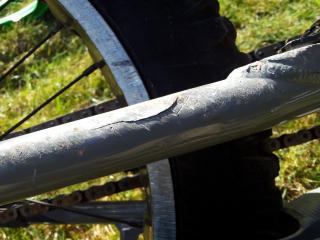

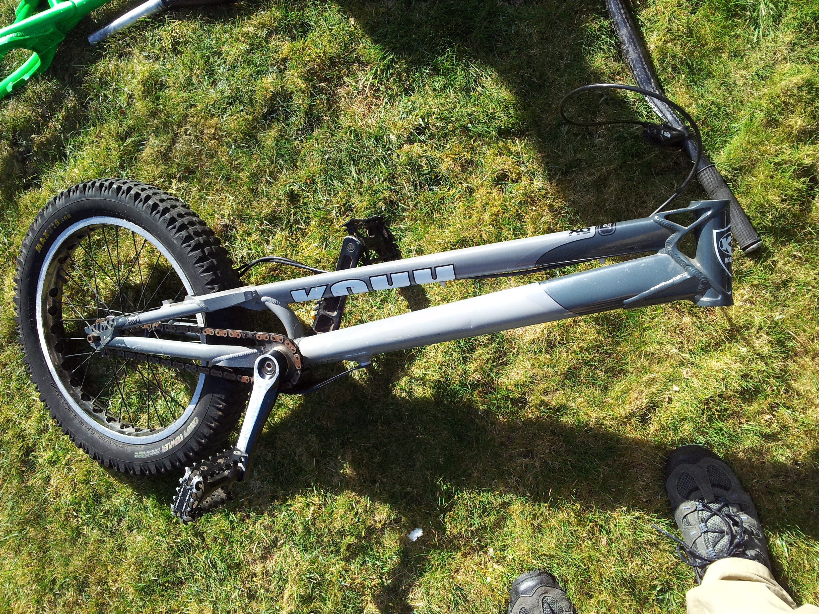

Balls Deep trials team Posted April 1, 2012 Report Share Posted April 1, 2012 Hi im about to purchace a koxx xp2 frame with a cracked chain stay from a dent ..my question is ..do you think the best way to repair it would to try get it welded or just wrap it in carbon fibre or both .. saw someone at my last comp do it to a downtube on an echo think its steve rodgers? when the frame is repaired it will only see light use as m girlfriend would be using it ...any ideas would help out alot Quote Link to comment Share on other sites More sharing options...
Rob Leech Posted April 1, 2012 Report Share Posted April 1, 2012 (edited) Has the frame cracked due to the dent or is it on a joint? If it's on a joint and over an inch long, get it welded, then wrap it. If it's not on a joint/no longer than an inch, just wrap it. If you look here- My link Thats everything you need (minus heat shrink tape, available from the same place). If you need any help with it let me know . I did it with steves because welding wouldn't last much longer than a week, and due to it's position, we had to remove any movement around the gusset, hence a rigid repair . Cheers, Josh. Edited April 1, 2012 by Rob Leech Quote Link to comment Share on other sites More sharing options...
Balls Deep trials team Posted April 1, 2012 Author Report Share Posted April 1, 2012 The crack isnt on a join bu it is about an inch long think i could just get away with just the carbon wrap ? thankyou for your reply Quote Link to comment Share on other sites More sharing options...
Revolver Posted April 1, 2012 Report Share Posted April 1, 2012 You could drill each end, it should prevent the crack from spreading, then wrap it in carbon. Quote Link to comment Share on other sites More sharing options...
Rob Leech Posted April 1, 2012 Report Share Posted April 1, 2012 The crack isnt on a join bu it is about an inch long think i could just get away with just the carbon wrap ? thankyou for your reply With the right prep work, yes. You have to make sure the area your wrapping is completely free of any paint/dirt/grease before starting and keep it that way the whole way through. Also, when you apply the first layer of resin (you apply one layer on it's own to allow the carbon to bond to the section as well as its self, and it will make it easier for you to wrap the carbon around the tube without it falling off), make sure you put a good amount in and around the crack, it's pretty strong stuff . You could drill each end, it should prevent the crack from spreading, then wrap it in carbon. You could do this, but in my experience, theres no point. If the crack wants to continue, all your doing by drilling it is allowing it to travel in a diferent direction, or most of the time, several . Cheers, Josh. 1 Quote Link to comment Share on other sites More sharing options...
