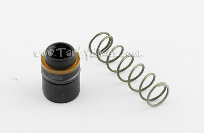

Both my magura's are slowly leaking from the levers and I need to replace them. Since magura have discontinued this spring and piston kit therfore Tarty have no stock I am wondering if this would work.
Heres a picture of it.
Now if I replace the rubber o-ring would it stop it from leaking or would I need to replace the orange bit at the top as well?
Cheers
Yes it should stop it leaking, worked fine for me as mine was seeping a bit of oil out.
The yellow part is just a lip seal as it there to stop grit and dirt getting into the cylinder. It doesn't actually seal any fluid so you shouldn't have to replace that (Y).

great cheers (Y)
