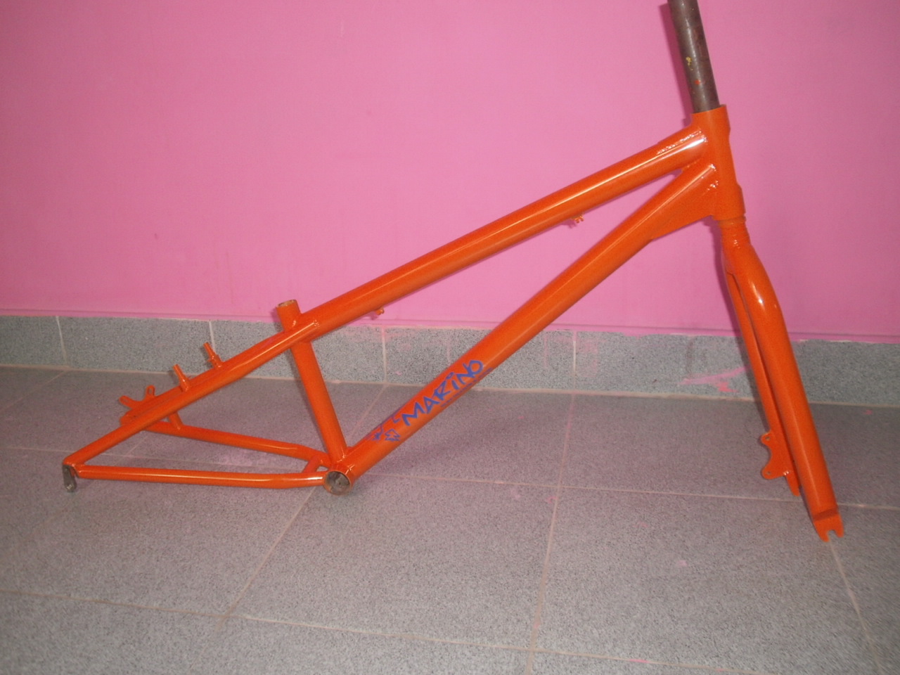

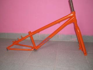

eskimo Posted March 27, 2012 Report Share Posted March 27, 2012 Marino have already started building my frame, with the same geo of the new 4play. The only difference is that I will use a 25.4 seatpost instead a 27.2, I think that it won't affect the frame, is it right? That's cool. Strictly speaking it could be weaker. But i know only the basics when it comes to materials, geo on the hand i know. I doubt you'll have an issue though. Here's my 24, it's basically a Skye with a slacker head angle. That's pretty nice, the trans coating is nice on any frame. Interesting how you went for a slacker HA on a short frame. Quote Link to comment Share on other sites More sharing options...

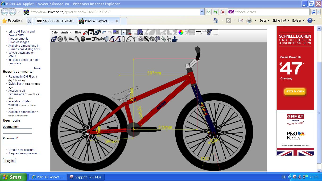

Chris Borneo Posted March 30, 2012 Report Share Posted March 30, 2012 Anyone know if he'll work to a drawing sent by email? Guess he probably won't have autocad but i figure if I send a PDF with all the dimensions on it, he should be able to work from that. Anyone done this? Quote Link to comment Share on other sites More sharing options...
JD™ Posted March 30, 2012 Report Share Posted March 30, 2012 Anyone know if he'll work to a drawing sent by email? Guess he probably won't have autocad but i figure if I send a PDF with all the dimensions on it, he should be able to work from that. Anyone done this? Yep, that's what I did. I didn't CAD it, I just used illustrator to draw a pic and sent it on over. He ends up drawing anything up himself anyway, so that he can draw it full size to compare to along the build. Quote Link to comment Share on other sites More sharing options...
bagre15 Posted March 30, 2012 Author Report Share Posted March 30, 2012 Anyone know if he'll work to a drawing sent by email? Guess he probably won't have autocad but i figure if I send a PDF with all the dimensions on it, he should be able to work from that. Anyone done this? I know that he uses bikeCad to design some bikes, but if you sent a drawing with mesures to him he would probably be able to work from that Quote Link to comment Share on other sites More sharing options...
Chris Borneo Posted March 30, 2012 Report Share Posted March 30, 2012 Cheers guys. Been drawing up what I want on autocad today. Geo is pretty rubbish on my current setup (69 degree head angle!) so i think I'm gonna have to go for it. I'll just dimension up what I've done and convert it to PDF and hope that's cool for him. That's the easy bit done, now I gotta get some funds together. Quote Link to comment Share on other sites More sharing options...
FamilyBiker Posted March 30, 2012 Report Share Posted March 30, 2012 (edited) Cheers guys. Been drawing up what I want on autocad today. Geo is pretty rubbish on my current setup (69 degree head angle!) so i think I'm gonna have to go for it. I'll just dimension up what I've done and convert it to PDF and hope that's cool for him. That's the easy bit done, now I gotta get some funds together. do it on bikecad.ca explains all... edit:oops,did i show my actual project,the "CUY"?please delete your memory modules Edited March 30, 2012 by FamilyBiker Quote Link to comment Share on other sites More sharing options...
