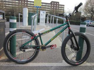

LEON Posted March 26, 2012 Report Share Posted March 26, 2012 Here's my 24, it's basically a Skye with a slacker head angle. It weighs 4.8 lbs, an inspired Skye weighs 5.3, so weight's really not an issue with the 4130 cro-mo, don't compare them to the old steel Marino's, they're nothing alike. Biggest thing I can say is do your homework with geometry! I like my bikes but given the choice I'd still make minor adjustments. I've treated this and my 26" quite badly deliberately and nothing whatsoever has bent/cracked/broke. I mean you could just build a Marino with Skye geo, it'd be half a kilo lighter and you'd save about a grand. Quote Link to comment Share on other sites More sharing options...
FamilyBiker Posted March 27, 2012 Report Share Posted March 27, 2012 (edited) skye=too short frontend for backwheel moves,i think.mine is basically a skye too,but with 365 cs and same wheelbase(longer frontend),bb +20.for this little more trialsy stuff. leon your bikes awesome.how high´s the bar from the ground? Edited March 27, 2012 by FamilyBiker Quote Link to comment Share on other sites More sharing options...
