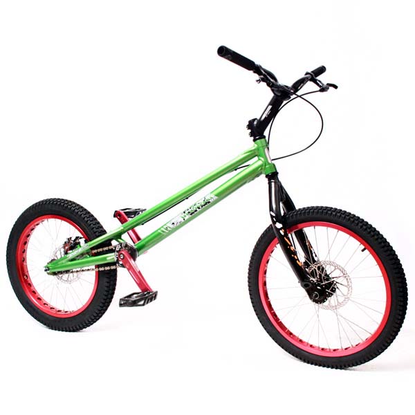

bagre15 Posted February 29, 2012 Report Share Posted February 29, 2012 I'm planning to give my frame a new paintjob and before painting it I want to cut a hole in my headtube, any size and technique recommendation? Another question, what do you think about these bike colors Quote Link to comment Share on other sites More sharing options...

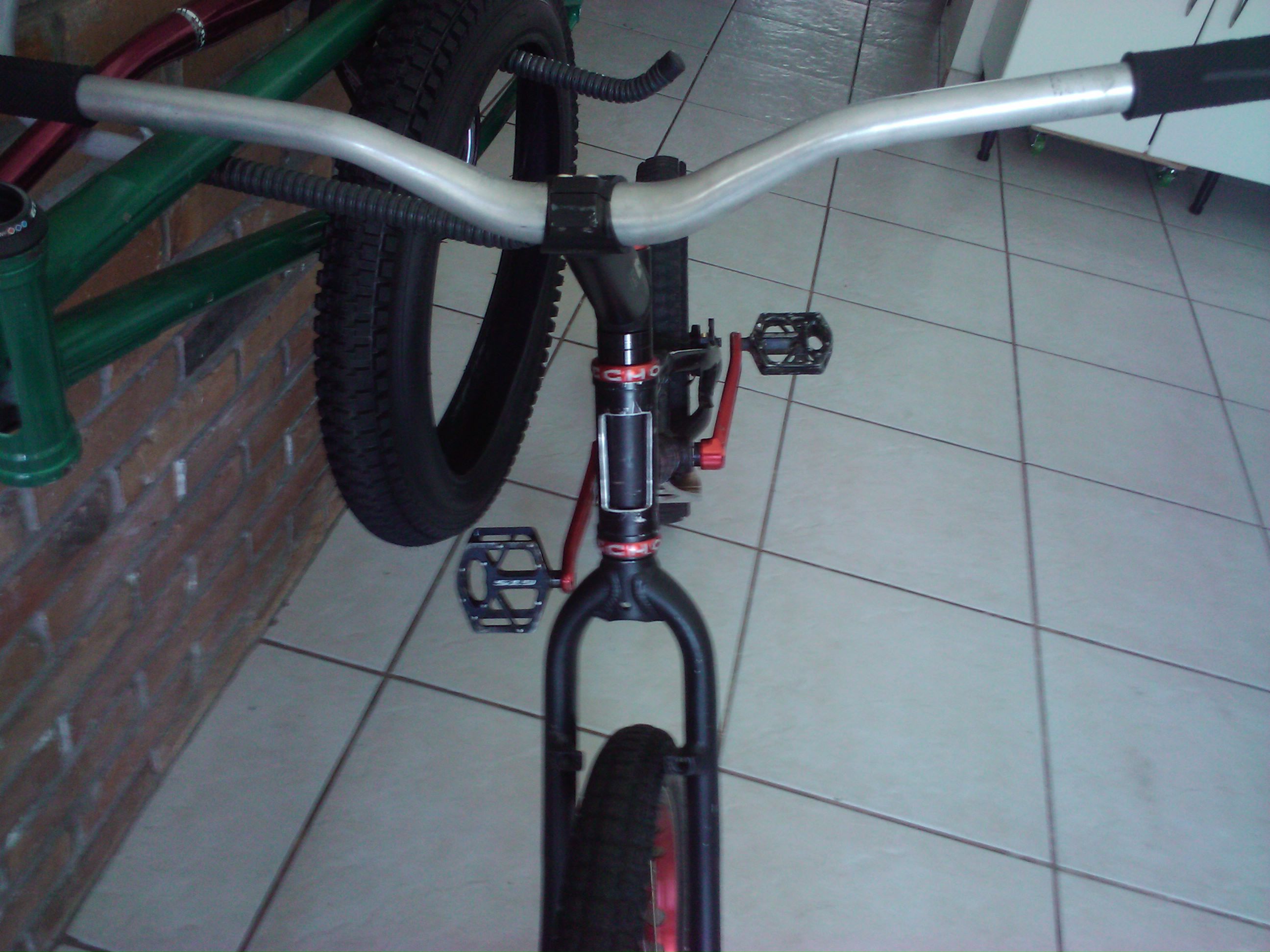

bagre15 Posted February 29, 2012 Author Report Share Posted February 29, 2012 I used a grinder followed by a dremel and a file. Worked quite well actually. I started the work today and used this method, but instead of the grinder I used a hacksaw It just need the final touches, the hole is already done I'll post some pics later Quote Link to comment Share on other sites More sharing options...
bagre15 Posted February 29, 2012 Author Report Share Posted February 29, 2012 Here is a pic, it isn't as good as the one that Alex Dark posted Do you think that I need to make the hole rounder? Quote Link to comment Share on other sites More sharing options...
alanczik Posted March 2, 2012 Report Share Posted March 2, 2012 man i know nothing about Headtube Cutting..but it looks soo cool!!! i think i'll do it too. do you fill any weakness there now?? or any whight save? or amm.. dirt go inside the tube??? (or something like that) Quote Link to comment Share on other sites More sharing options...
PaRtZ Posted March 5, 2012 Report Share Posted March 5, 2012 Milling machine, 4 flute end mill, no coolant. How come you used an end mill to make a slot? Surely a slot mill makes sense... Quote Link to comment Share on other sites More sharing options...
forteh Posted March 5, 2012 Report Share Posted March 5, 2012 How come you used an end mill to make a slot? Surely a slot mill makes sense... I'm going to hazard a guess that the end mill will give a better surface finish than a slot drill (more flutes) because you're cutting sideways into the material rather than actually slotting it Quote Link to comment Share on other sites More sharing options...
PaRtZ Posted March 5, 2012 Report Share Posted March 5, 2012 I'm going to hazard a guess that the end mill will give a better surface finish than a slot drill (more flutes) because you're cutting sideways into the material rather than actually slotting it definitley... BUT you got the have an end/edge to give said finish before you can start! End mills aren't designed fo cutting 'holes' or 'slots' they are as you say designed for that beautiful edge. Just wondered if there was another reason thats all! If not then meh who cares Quote Link to comment Share on other sites More sharing options...
