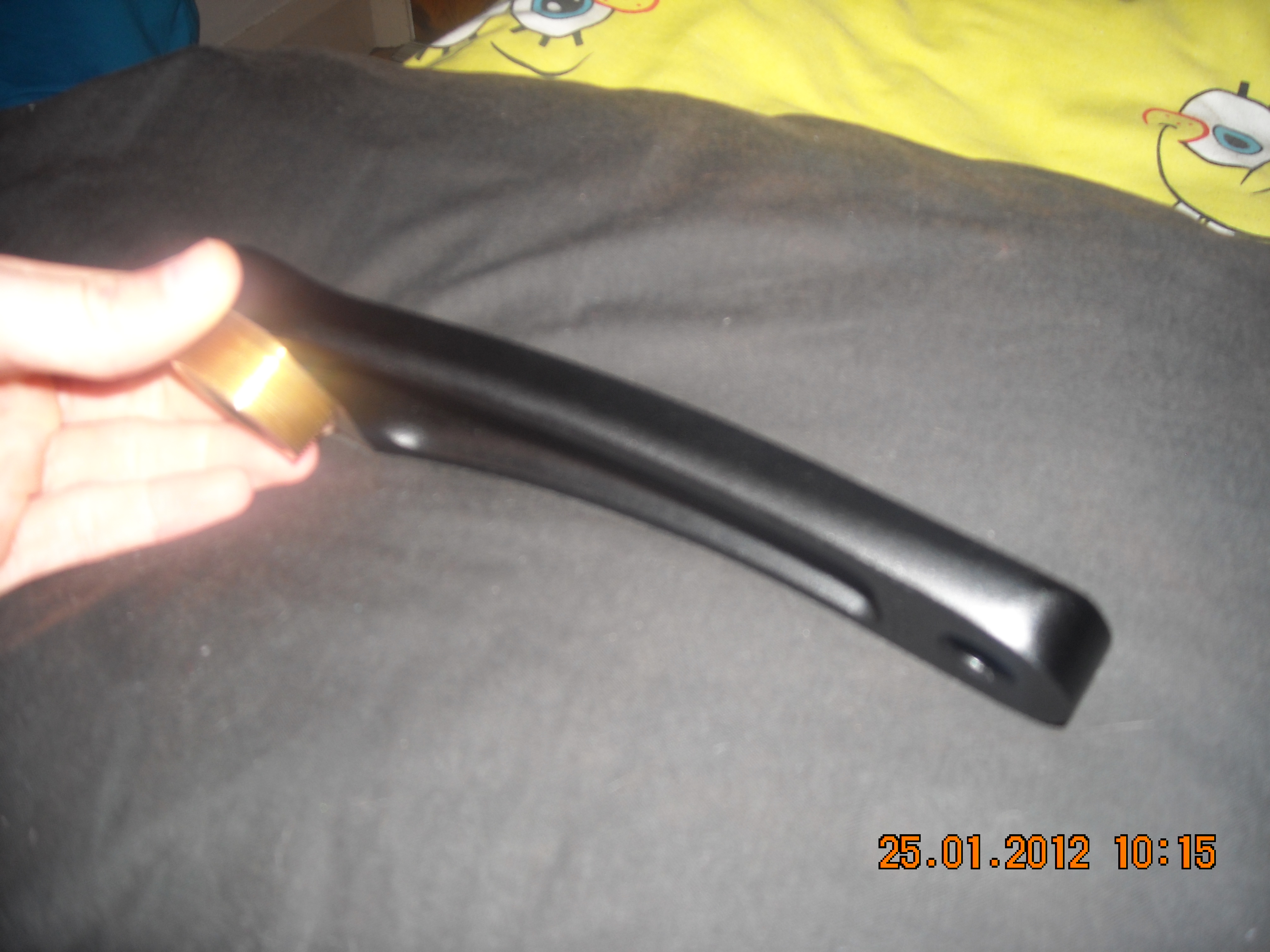

CalRobbo341 Posted February 24, 2012 Report Share Posted February 24, 2012 (edited) This is the second time this has happened to me now! Right, I have these cranks but in 165mm, square taper and a different bash ring, and the first time after a while the left hand crank where the pedal goes the thread just disappeared, and just out testing my new booster and I put a new pedal in the other day and the thread has just gone, completely. Is it worth buying a tap and dye kit, or buy a new crank or unless anyone knows a good way of getting it to stay? Worse thing is I am meant to be riding Liverpool tomorrow Oh and I also have a spare right hand crank so could I use that instead of buying anything? Thanks Edited February 24, 2012 by Callumm Quote Link to comment Share on other sites More sharing options...

Philly_Biker Posted February 25, 2012 Report Share Posted February 25, 2012 post a pic. If the threads are completely gone then there is no material to tap to the same size. Sounds like you need a new part. Could get someone to weld the hole shut then drill and retap it. Quote Link to comment Share on other sites More sharing options...

CalRobbo341 Posted February 25, 2012 Author Report Share Posted February 25, 2012 (edited) I do pedal backwards quite a lot and I am doing a welding course in college but I don't want to go through that much trouble, my next questions is could I use a right hand crank (the one that you put the free wheel on)? It also may look like they have thread on, it does the tiniest bit but it will not go all the way on and stay tight on. Can I use this crank (the one with the free wheel?) Thanks Edited February 25, 2012 by Callumm Quote Link to comment Share on other sites More sharing options...

Mark W Posted February 26, 2012 Report Share Posted February 26, 2012 On 2/26/2012 at 3:48 PM, Revolver said: Yeah, not as tight as he must be doing them up, though. They strip from being too loose rather than too tight. On the face of the crank arm you can see that around the hole where the pedal axle goes there's a sort of gouge around half of it - that's where the bike's been pedalled (quite a lot by the looks of things?) with the pedal loose, and as it wobbles a bit the shoulder at the end of the threaded section of the pedal axle just mashes into the crank arm. While that's going on, the threads are getting stripped too. If you can't find a suitable replacement, we offer a pedal thread helicoiling service. Think it's around £10-12 for it, so usually cheaper than buying a brand new single crank arm. Quote Link to comment Share on other sites More sharing options...

CalRobbo341 Posted February 26, 2012 Author Report Share Posted February 26, 2012 On 2/26/2012 at 3:53 PM, Mark W said: If you can't find a suitable replacement, we offer a pedal thread helicoiling service. Think it's around £10-12 for it, so usually cheaper than buying a brand new single crank arm. Was looking on the site yet I couldn't see it, must have just skipped past it.. Shall do that as it is the cheaper option Could you perhaps tell me what to do though :L, purchase the option, I pay for postage, you do the job, then I pay for postage again? Thanks Quote Link to comment Share on other sites More sharing options...
Mark W Posted February 26, 2012 Report Share Posted February 26, 2012 You can either do that or just post the crank arm and pedal back to us with a contact number 'n' stuff, then we'll give you a call once we've got it to sort out everything else. Quote Link to comment Share on other sites More sharing options...
CalRobbo341 Posted February 26, 2012 Author Report Share Posted February 26, 2012 On 2/26/2012 at 4:10 PM, Mark W said: You can either do that or just post the crank arm and pedal back to us with a contact number 'n' stuff, then we'll give you a call once we've got it to sort out everything else. So helpful! Will do that on Tuesday then Thanks Quote Link to comment Share on other sites More sharing options...
