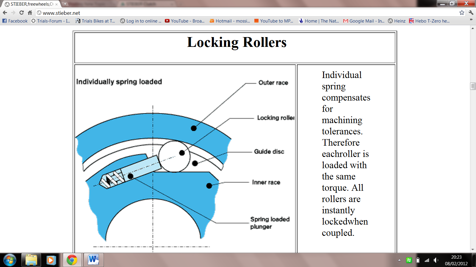

Sam Moss Posted February 8, 2012 Report Share Posted February 8, 2012 i found a one way bearing in work and wondered could it be used as a freewheel on a bike. Who knows what a one way roller bearing is and how it works? heres a link... http://www.stieber.net/ Its basically a bearing that only spins one way, you could say its a free wheel with 'unlimited' engagements. Im wondering could a freewheel be made the same way that these are made? im not sure how much force they could take or if they would skip, does anybody know? This could be the future of freewheels if it could handle the force! Quote Link to comment Share on other sites More sharing options...

bing Posted February 9, 2012 Report Share Posted February 9, 2012 one way or clutch bearings, are used alot in the print industry, with which me and the old fella have alot of experience. if a printing machine can handle being stopped from 14,000iph (impressions per hour) to a dead stop when an e stop is pressed, and they dont let go, a 14 yearold jumping up a wall is no where near the amount of load. getting it to fit on the hub is the hard bit, as bearing steel is very very hard, and very hard to work with. in my mind it would work. but i`m not a bloke in the bike industry, just used to be a fitter, and know a bit about bearings. Quote Link to comment Share on other sites More sharing options...
ghostrider88 Posted February 9, 2012 Report Share Posted February 9, 2012 Another one who doesn´t read before posting?There´s hub that uses that system and it´s not durable enough for trials use.Got it? Quote Link to comment Share on other sites More sharing options...
Revolver Posted February 10, 2012 Report Share Posted February 10, 2012 Another one who doesn´t read before posting?There´s hub that uses that system and it´s not durable enough for trials use.Got it? Er, actually he was talking about the strength of the bearing itself. It's the hubshell that breaks on these hubs. Quote Link to comment Share on other sites More sharing options...
ghostrider88 Posted February 10, 2012 Report Share Posted February 10, 2012 Er, actually he was talking about the strength of the bearing itself. It's the hubshell that breaks on these hubs. Of course the bearings are strong,they are small and made of stainless steel,if someone could make the hubshell from the same material,it might work,but it would weight 2pounds or even more.Stealth hubs aren´t weak or light by any means(500g),yet they won´t last when used for trials.Based on this,I would say this isn´t way to go. Quote Link to comment Share on other sites More sharing options...
