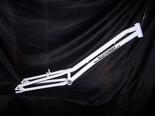

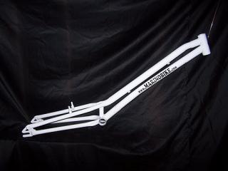

FamilyBiker Posted January 4, 2012 Report Share Posted January 4, 2012 (edited) if marino can build this kind of top/downtube area,he sure can build a gu tp replica.ask him.tell him peter told you edit:if you heat treat a frame yourself and dont know EXACTLY what you´re doing you´ll produce a frame made of emmentaler cheese...lol Edited January 4, 2012 by FamilyBiker Quote Link to comment Share on other sites More sharing options...

FamilyBiker Posted January 4, 2012 Report Share Posted January 4, 2012 just thought about what a new gu tp frame would cost,around 400eur?mr.alegre does heat treating in the near future,so it hasnt to be called cheap anymore.his weldings are amazing. didnt mean to do commercials here,was just a tip and the answer for the "doesnt look like gu"-post. wont say marino again now. promise greets 1 Quote Link to comment Share on other sites More sharing options...
ghostrider88 Posted January 4, 2012 Report Share Posted January 4, 2012 if marino can build this kind of top/downtube area,he sure can build a gu tp replica.ask him.tell him peter told you edit:if you heat treat a frame yourself and dont know EXACTLY what you´re doing you´ll produce a frame made of emmentaler cheese...lol I actually like that white frame(might have something to do with the V-brake posts),what was the price?A I can´t find the pricing at his webpage anymore. Quote Link to comment Share on other sites More sharing options...
FamilyBiker Posted January 4, 2012 Report Share Posted January 4, 2012 cheap(mild)steel:120 usd 4140CrMo:250usd plus shipping,depends on distance from peru.i paid 65 usd shipping. forgive me,luke,but he asked Quote Link to comment Share on other sites More sharing options...
ghostrider88 Posted January 4, 2012 Report Share Posted January 4, 2012 cheap(mild)steel:120 usd 4140CrMo:250usd plus shipping,depends on distance from peru.i paid 65 usd shipping. forgive me,luke,but he asked And that frame is actually yours?I would like to see it builded Quote Link to comment Share on other sites More sharing options...
FamilyBiker Posted January 4, 2012 Report Share Posted January 4, 2012 (edited) not mine,just for example mine is the "Kamel" is from a peruvian guy http://marinobike.blogspot.com/2008/07/marino-kamel.html Edited January 4, 2012 by FamilyBiker Quote Link to comment Share on other sites More sharing options...
