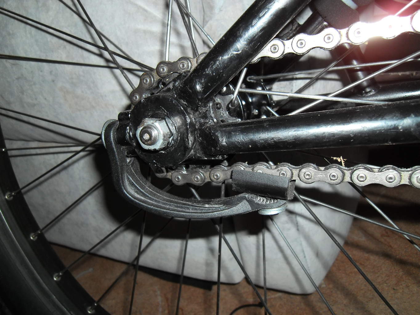

The Mechanic Posted December 29, 2011 Report Share Posted December 29, 2011 (edited) I have made my own tensioner which seems to work well although it works over the chain rather than under that you require, The torsion spring is the tough bit, making a mounting not so hard, I went for a coil rather than leaf type spring good movement in either direction which I think is important.Leaf spring are good in compression but restricted expansion. Edited December 29, 2011 by The Mechanic Quote Link to comment Share on other sites More sharing options...
FamilyBiker Posted December 30, 2011 Report Share Posted December 30, 2011 works so good,i cant believe it(plastic) Quote Link to comment Share on other sites More sharing options...
Chris Borneo Posted December 31, 2011 Author Report Share Posted December 31, 2011 That looks amazing. What's the arm made from?Is it a reflector bracket? Quote Link to comment Share on other sites More sharing options...
FamilyBiker Posted January 2, 2012 Report Share Posted January 2, 2012 (edited) no,its a mudguard mount from a cheap supermarket atb i´ve been throwing away. from those rear mudguards for cheap fullys. works awesome edit:reflector bracket would be even better i think,would be more adjustable. i´ll try one out. Edited January 3, 2012 by FamilyBiker Quote Link to comment Share on other sites More sharing options...
