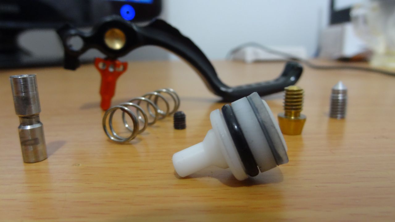

iman-k Posted December 29, 2011 Report Share Posted December 29, 2011 Hi Friends . i have a ECHO SL Lever + Echo TR Slave Cylinder 2011 , i have the Similar problem and i think my brake leak, it will be better If i Bleed with water ? i bleeding it with dot 4 oil . what should i do? sorry for my bad english Quote Link to comment Share on other sites More sharing options...
SamKidney Posted December 29, 2011 Report Share Posted December 29, 2011 Hi Friends . i have a ECHO SL Lever + Echo TR Slave Cylinder 2011 , i have the Similar problem and i think my brake leak, it will be better If i Bleed with water ? i bleeding it with dot 4 oil . what should i do? sorry for my bad english Wrong fluid for the brake. Echo/ Magura brakes are meant to be bled with mineral oil, not synthetic DOT fluids. Chances are your seals are ruined as a result of contacting the DOT fluid, and it's now leaking. New O-ring for your lever piston, and new slave cylinders, bled with magura royal blood with sort it. 1 Quote Link to comment Share on other sites More sharing options...
iman-k Posted December 29, 2011 Report Share Posted December 29, 2011 Wrong fluid for the brake. Echo/ Magura brakes are meant to be bled with mineral oil, not synthetic DOT fluids. Chances are your seals are ruined as a result of contacting the DOT fluid, and it's now leaking. New O-ring for your lever piston, and new slave cylinders, bled with magura royal blood with sort it. Thanks for your help but i can't buy new slave cylinders and magura blood in Iran it will be wrong if i bleed with water? Quote Link to comment Share on other sites More sharing options...
SamKidney Posted December 29, 2011 Report Share Posted December 29, 2011 Thanks for your help but i can't buy new slave cylinders and magura blood in Iran it will be wrong if i bleed with water? You can try with water, but I would say the damage has already been done. Might have to track down some slaves if you can. All I can suggest 1 Quote Link to comment Share on other sites More sharing options...
iman-k Posted December 29, 2011 Report Share Posted December 29, 2011 OK i find Shimano Disk brake mineral oil here , theres a problem to bleed with shimano mineral oil ? i opened my lever and cleaned all parts of lever , is a way to open the cylinders and clean them? Thanks again for helps Quote Link to comment Share on other sites More sharing options...
SamKidney Posted December 29, 2011 Report Share Posted December 29, 2011 OK i find Shimano Disk brake mineral oil here , theres a problem to bleed with shimano mineral oil ? i opened my lever and cleaned all parts of lever , is a way to open the cylinders and clean them? Thanks again for helps Should be no problem bleeding it with shimano oil And you cant disassemble slaves. Bleed the brake up and hope it works 1 Quote Link to comment Share on other sites More sharing options...
