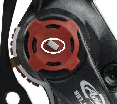

Kenny--Trials Posted December 26, 2011 Report Share Posted December 26, 2011 (edited) Hey I need a new part for a bb7 but I don't know what it is to search it up on eBay so was wondering if anyone could find me the part on eBay or give me the name of the part? Here it is: Edited December 27, 2011 by Kenny--Trials Quote Link to comment Share on other sites More sharing options...

Laurence--Trials Posted December 27, 2011 Report Share Posted December 27, 2011 That little peice there is the ajuster nob, when you wind it in and out it pushes the piston out. The little nob bit is a two part thing, a little piston shaped tpa then attached to that is the actual piston. Quote Link to comment Share on other sites More sharing options...
Kenny--Trials Posted December 27, 2011 Author Report Share Posted December 27, 2011 So the red bit comes with the bit that I circled? Quote Link to comment Share on other sites More sharing options...
craigjames Posted December 27, 2011 Report Share Posted December 27, 2011 This this is what you need, but yes it comes as a kit with the part you circled and the red adjuster knob together. Quote Link to comment Share on other sites More sharing options...

Chris Borneo Posted December 27, 2011 Report Share Posted December 27, 2011 (edited) Anyone looked on the Avid website yet? Just had a look at their technical manual and spares catalogue and I think the bit you're after is the foot screw and I think might be part of the internals kit, not the adjuster kit. craigjames may have already bought this kit in the past though and tell me I'm wrong. Edited December 27, 2011 by Chris Borneo Quote Link to comment Share on other sites More sharing options...
Laurence--Trials Posted December 27, 2011 Report Share Posted December 27, 2011 Kenny... you've ordered the wrong side you nobber! You wanted the piston closest to the wheel! Quote Link to comment Share on other sites More sharing options...
