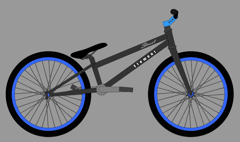

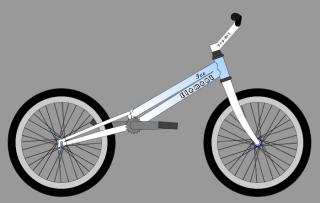

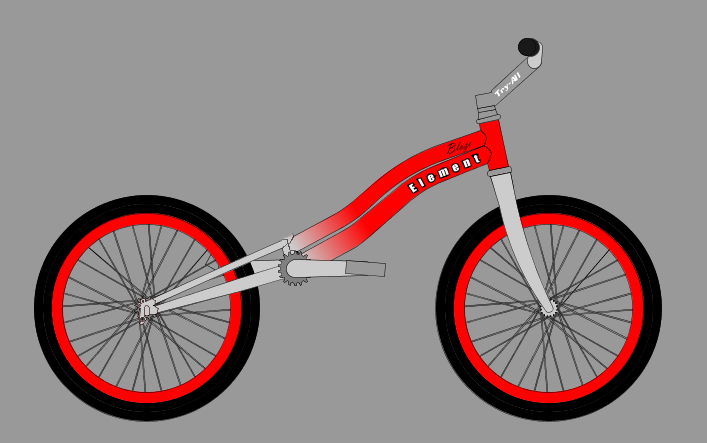

Hey guys, I've recently been faffing about on a small computer program called BikeCAD. Allows you to design bike frames and parts, and I had a bit of a brain fart (idea)! I'd really love to start a small bike company, but I'm only 16 with no real experience in building frames or forks - only building bikes up and setting them up. If anyone has any advice about frame suppliers, how to build my own frame and forks or knows someone who I could hire/pay to build me a custom one that would be much appreciated.
Here are some of my designs:
(Also any feedback on the designs themselves would be appreciated! e.g. if at the right price would you buy? etc.)
And I also have frame geo's for all designs :)

If you want some simple steel frames build with custom geo it might be worth getting in touch with Marino.
A few people off here have bought frames from him and it seemed to be reasonably trouble free.
Would steel not be too heavy? I was rather hoping for Alloy or Aluminium - possibly a 7005 Alloy or something like that.
Thats pretty amazing to watch lol... So what would I do? Just send him the picture, and frame geo or something? Work out a price? :)
nah he just done that as a project for the college i think, but i know doubt he could give you a few pointers on how to go about doing it, and what he got stuck with
Well for someone to make you a one off, completely custom alu frame I wouldn't be suprised if they wanted near the £700 mark.
Just sayin'.
Wow... So would be cheaper for me to educate myself about the whole process and build one myself no? How much you reckon I'd need for the metal :/
Not to mention aftermarket parts, but they'd come after...
Buying a half decent tube set is going to cost you quite a bit.
You'll need access to mills and lathes unless you want to pay out extra for having someone do that for you.
You'll need to learn how to weld (properly).
Then you'll need to find somewhere to get the thing heat treated which is going to add more £££
Altogether it'll end up being quite costly.
I'm not trying to put you off - just be prepared for alot of hard work to get anywhere near a result you'll be happy with.
