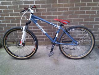

Chris Borneo Posted December 15, 2011 Report Share Posted December 15, 2011 Just picked this up off ebay. Weighs in at 6lbs so maybe a bit on the heavy side for some but I like a bike that'll take a bit of abuse. Planning to build it up over the next few weeks as a kinda trials/street/jump bike. 2 Quote Link to comment Share on other sites More sharing options...

Chris Borneo Posted December 16, 2011 Author Report Share Posted December 16, 2011 Just started with the paint stripper. Massive fail! Barely having an effect on the powder coat and I'm using the old formula nitromors. Cannot be bothered with this shit. Powder coat they've used is as tough as the frame it's self I reckon. Gonna have to strip it all round the main gusset at least so I can be sure to cut that out straight. Then it looks like I'll have to get it shot blasted and might as well get a proffessional clear coat while it's there, instead of the rattle can job it was going to get. So much for doin it on the cheap eh. Quote Link to comment Share on other sites More sharing options...

Chris Borneo Posted December 26, 2011 Author Report Share Posted December 26, 2011 Just got round to starting work on the Rocket. This was as much powder coat as I could get off with nitromors. Made the first cuts but couldn't get any closer with the full size hacksaw. Used a junior hack saw to get in a bit closer. Then started with the file. Last pic I could get before the light faded and the missus had me in for dinner. I'll finish it up tonight and start work on the custom head badge I'm gonna be making. Made this one already for an old club racer I restored with a mate in the summer. Not sure yet if I'm going to go with the same design or something new. Quote Link to comment Share on other sites More sharing options...
Chris Borneo Posted January 14, 2012 Author Report Share Posted January 14, 2012 Quick update on the rocket. Got the gusset filed to the shape I want. Just got to get the money together for the clear coat now. Meanwhile I've managed to blag a lend on a rear wheel from my mate Dave who's already been good enough to let me use his rocket frame, til mine's sorted. Just got to paint the bars and the front end's done, short of a brake but that'll come later. Quote Link to comment Share on other sites More sharing options...

Rusevelt Posted January 16, 2012 Report Share Posted January 16, 2012 Tidy set-up however, this steed would ride so much sweeter if you run shorter length forks, and higher rise stem and bars. Quote Link to comment Share on other sites More sharing options...
Ben Swales Posted January 16, 2012 Report Share Posted January 16, 2012 This looks sweet. I used to love the Rocket frames back in the day, could never afford one though! It took me ages to work out how you'd added the port holes and nose cone to the rocket in this picture, then I realised it was part of the workbench underneath! Trippy... 4 Quote Link to comment Share on other sites More sharing options...
Chris Borneo Posted January 16, 2012 Author Report Share Posted January 16, 2012 Tidy set-up however, this steed would ride so much sweeter if you run shorter length forks, and higher rise stem and bars. You'd be surprised. Forks are only 40mm taller than most 26" trials forks so head angle is still okay and the bb is about the right height with this setup. Only down side is a bit of a lack of clearance up top which I can live with for now. This looks sweet. I used to love the Rocket frames back in the day, could never afford one though! It took me ages to work out how you'd added the port holes and nose cone to the rocket in this picture, then I realised it was part of the workbench underneath! Trippy... Ha ha, hadn't even noticed. That is a bit trippy Quote Link to comment Share on other sites More sharing options...
ghostrider88 Posted January 16, 2012 Report Share Posted January 16, 2012 You'd be surprised. Forks are only 40mm taller than most 26" trials forks so head angle is still okay and the bb is about the right height with this setup. Only down side is a bit of a lack of clearance up top which I can live with for now. 40mm is huge difference,it´s like having 80mm suspension fork 1 Quote Link to comment Share on other sites More sharing options...
Chris Borneo Posted January 16, 2012 Author Report Share Posted January 16, 2012 Yeah, I figure the head angle is about 71.5 now. Like I said it's okay. It was never meant to be a pure trials build. More an allrounder for a bit of street/trials and also to be able to go for a hack down the woods. If I get right back into the street trials thing I may look at something else. Quote Link to comment Share on other sites More sharing options...
