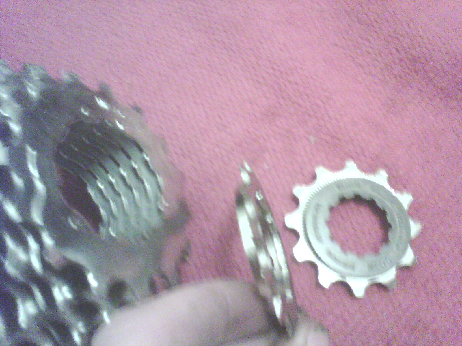

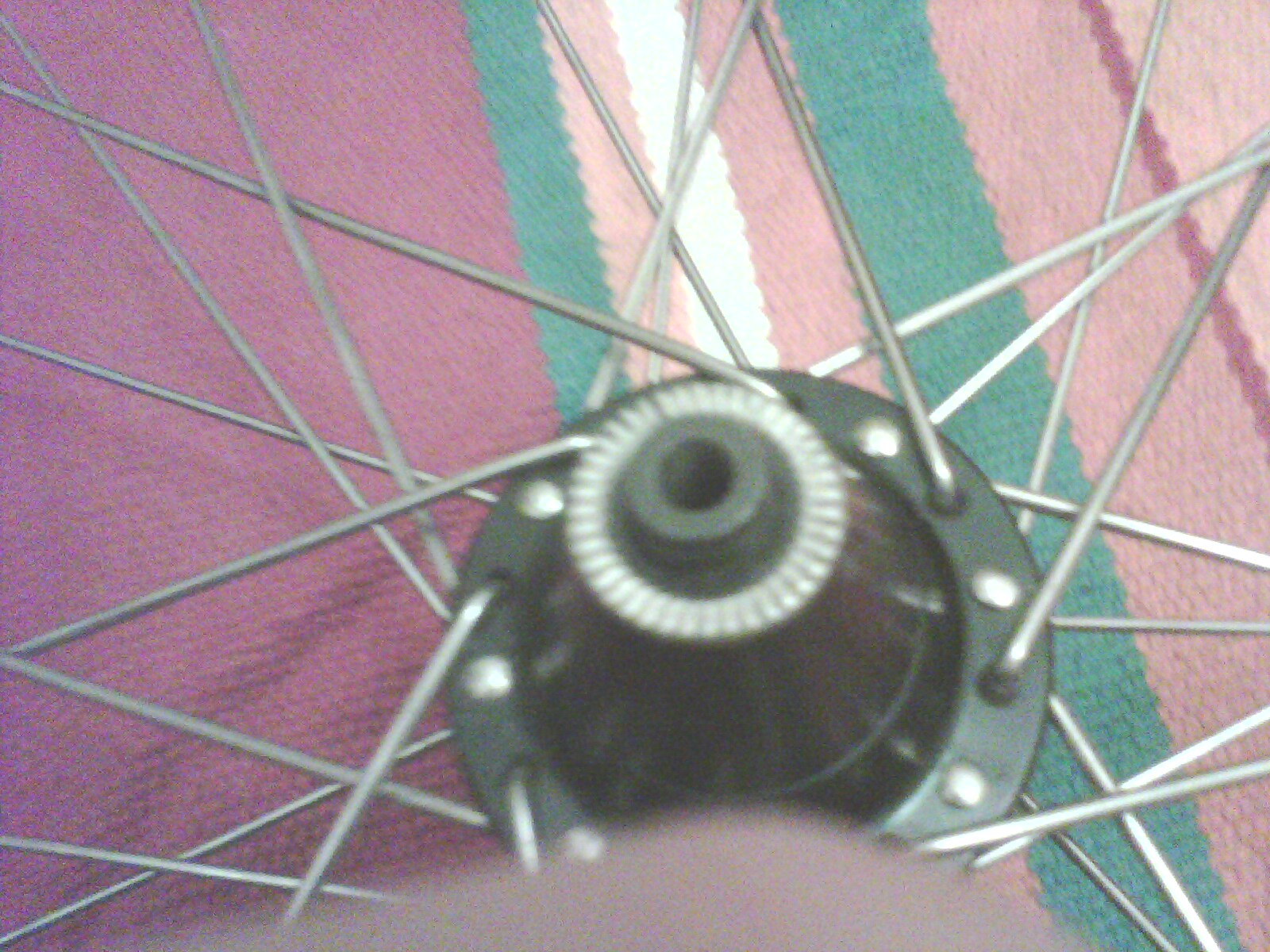

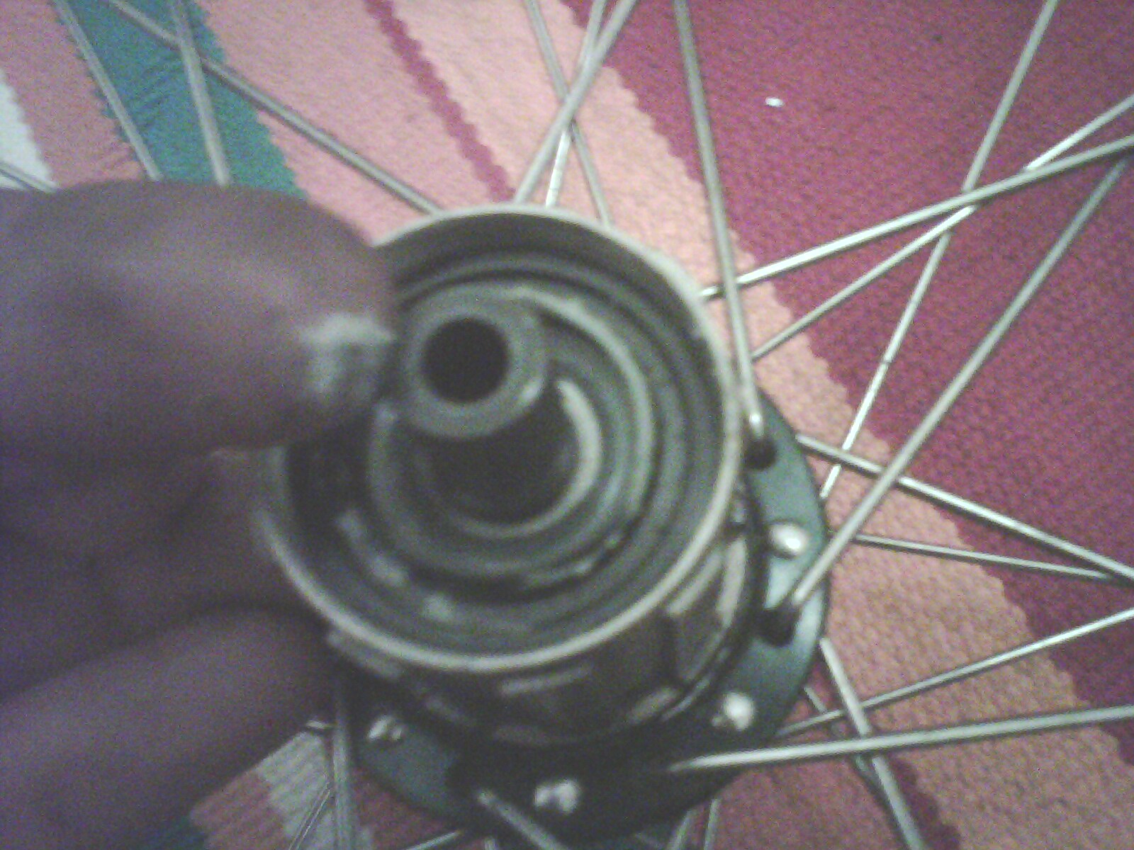

LordAssworthMcThor Posted December 17, 2011 Author Report Share Posted December 17, 2011 (edited) Got it. I will go for the Hope hub. Just started taking apart my wheel, was worryingly easy to do it bare handed. Pics of what I've done are below, but I don't get how to remove the freewheel, theres only one place to put a tool and nothing to turn it against, everything else is round without ridges or anything.. Anyway, as you can see the cassette has fallen apart. This was only about 2 weeks old, and the same thing happened to the previous cassette. Dunno how clear it is but there are little plastic rings which hold each gear together, the two bottom ones are missing the plastic ring. Why has this exact thing happened twice, cheap cassette (Shimano HG50 or something to do with the hub? Any ideas? And can it/is it worth fixing, if not any suggestions on what to get for a replacement? Since I'm gonna get a new hub the other pics aren't really that important. Edited December 17, 2011 by LordAssworthMcThor Quote Link to comment Share on other sites More sharing options...
Ali C Posted December 17, 2011 Report Share Posted December 17, 2011 your hub is a "freehub" rather than a "freewheel". A freehub has the engagement system built in (usually ratchets and pawls) and a splined area to slide a cassette (or single cogs) onto with a lockring to tighten them up. A freewheel is a single enclosed engagement system (again with ratchets and pawls) with threads which allow you to screw it onto specific hubs or cranks. it sounds like the engagement system in your hub has broken (not surprising as it's a cheap hub and trials puts huge stresses through them). You may be able to repair it but as everyone else is suggesting a full hub upgrade would be worth while. Af far as the cassette is concerned, it looks fine to me? The bottom two cogs usually don't have plastic spacers and just have a wider base. Quote Link to comment Share on other sites More sharing options...
bing Posted December 17, 2011 Report Share Posted December 17, 2011 (edited) Got it. I will go for the Hope hub. Just started taking apart my wheel, was worryingly easy to do it bare handed. Pics of what I've done are below, but I don't get how to remove the freewheel, theres only one place to put a tool and nothing to turn it against, everything else is round without ridges or anything.. Anyway, as you can see the cassette has fallen apart. This was only about 2 weeks old, and the same thing happened to the previous cassette. Dunno how clear it is but there are little plastic rings which hold each gear together, the two bottom ones are missing the plastic ring. Why has this exact thing happened twice, cheap cassette (Shimano HG50 or something to do with the hub? Any ideas? And can it/is it worth fixing, if not any suggestions on what to get for a replacement? Since I'm gonna get a new hub the other pics aren't really that important. the freehub, if i`m correct, is the same as a cheap shimano one, and needs the axle out to remove the freehub from the hub body, using an 8/10mm allen key. this is a fairly simple job, and will ascertain which part is knackered. the one i`m gonna send you is exactly the same, so you should be able to just swap it over. Edited December 17, 2011 by danchandler Quote Link to comment Share on other sites More sharing options...
sstein Posted December 23, 2011 Report Share Posted December 23, 2011 any chance of a photo of the hub from above (also any markings on the hub)? If I am not mistaken than looks like one of the old onza oem hubs which weren't actually intended for trials use. If so it may just be a simple matter of replacing some broken pawls or springs which takes minimal effort Quote Link to comment Share on other sites More sharing options...
