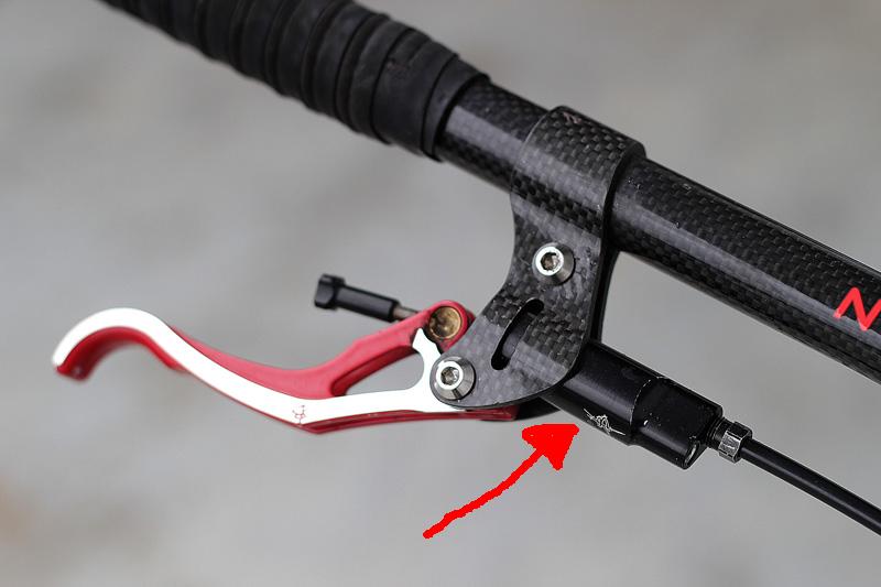

isitafox Posted December 6, 2011 Report Share Posted December 6, 2011 You also mentioned that the whole "cylinder thing was moving", did you mean the master cylinder in the lever was moving? In what way is it moving? He means this bit here can be turned around Mine did the same, I don't think that's the problem it sounds more like a bad bleed or the piston/seal in the levers fooked. Quote Link to comment Share on other sites More sharing options...
forteh Posted December 6, 2011 Report Share Posted December 6, 2011 I use an RB lever and recently suddenly lost all hold, it was as if the TPA was wound right in and the piston was bottoming out in the master cylinder. Turns out that the TPA adjuster had cracked almost all the way through (the thumbwheel on the end of the adjuster clashes with the lever and flexes the threaded rod causing fatigue) and was flexing enough to stop the brake holding. Replaced it with an M3 screw and all sorted If it isn't leaking then you must have air in there, did you rotate the cylinder (the bit you said turns) so the bleed screw is at the highest point in the brake system? The cylinder shouldn't turn when the lever is tightened onto the bars, if it is you have something wrong. Also you have got the ball bearing behind the bleed screw haven't you? It is required to seal the lever. Failing all of that working, strip the lever down, clean and inspect it. They're very simple, nothing really to go wrong in there. Quote Link to comment Share on other sites More sharing options...
