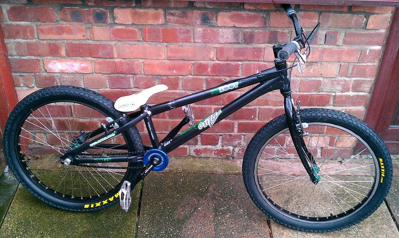

MonsieurMonkey Posted December 3, 2011 Report Share Posted December 3, 2011 Okay, so here it is. After many weeks waiting and probably about 6 hours of killing myself. It's done, I ain't doing a spec, mainly because I don't know my self. And only one picture, mainly because I'm not a photographer, nor is the bike clean or pretty. Front brake isn't working, I need a little grub screw to get that sorted, no idea if things on the rear wheel are right. (I think they're for 360 drop outs, but right now it's all I have, so yeah.) My back hurts, pretty much every one of my fingers has been injured, I hate cutting brake cable, I hate setting up vees, I hate cutting down seat tubes, I hate that my forks are still wobbling but it seems intermittent, which is f**king annoying when trying to work out whatever it is. But I love my bike. Putting it together was a son of a bitch, but when it was finished I was proper chuffed. Finally a huge thanks to everyone who helped me with this, whether you gave me free shit or cheap shit, or even full priced shit, thanks a lot. I had a list of names, but it's taken me so long to sort I'm not sure where it is, anonymous appreciation is far more fulfilling anyway. Big kudos to Rainbird, who has put up with a ridiculous amount of PMs and has always helped me out with info instead of telling me to get f**ked and google it myself. That isn't favouritism, but he started the charity thread and sent me essays on how to do stuff. Anyway, thanks to you all. I'm going to lie down, my back is seriously killing. 7 Quote Link to comment Share on other sites More sharing options...
Laurence--Trials Posted December 3, 2011 Report Share Posted December 3, 2011 (edited) I hate that my forks are still wobbling but it seems intermittent, which is f**king annoying when trying to work out whatever it is. Thats your headset, you need to tighten the bolt that goes though the topcap, dont over do it though, just enough to stop the wobble. Edited December 3, 2011 by Laurence--Trials Quote Link to comment Share on other sites More sharing options...
MonsieurMonkey Posted December 3, 2011 Author Report Share Posted December 3, 2011 Thats your headset, you need to tighten the bolt that goes though the topcap, dont over do it though, just enough to stop the wobble. Cheers mate, its been sorted now. Think I may have over tightened it a bit seeing as some plastic thing from the headset got crushed to shit. Quote Link to comment Share on other sites More sharing options...

Skoze Posted December 3, 2011 Report Share Posted December 3, 2011 Good to see my spares bin in full use there!!! As you said, yeah that rear wheel's set up for 360 dropouts, can either switch the big spacers for washers, or put a standard QR through it if you don't wanna run that Quote Link to comment Share on other sites More sharing options...
MonsieurMonkey Posted December 3, 2011 Author Report Share Posted December 3, 2011 Good to see my spares bin in full use there!!! As you said, yeah that rear wheel's set up for 360 dropouts, can either switch the big spacers for washers, or put a standard QR through it if you don't wanna run that Does it matter? If the wheels not gonna slip out I'll leave it until a later date. But if I'm going to die because of It I'll get it sorted Quote Link to comment Share on other sites More sharing options...

Skoze Posted December 3, 2011 Report Share Posted December 3, 2011 I'd recommend a QR just to be on the safe side, they've got serrated ends to keep things in check Quote Link to comment Share on other sites More sharing options...
MonsieurMonkey Posted December 3, 2011 Author Report Share Posted December 3, 2011 Cool, I'll sort one ASAP. Cheers for all the comments guys. My first ride will be tomorrow hopefully. Ps. My back was killing from all the bending and shit from building the bike Quote Link to comment Share on other sites More sharing options...

Sam Nichols Posted December 10, 2011 Report Share Posted December 10, 2011 Alternatively, leave the 360° dropout spacers where they are and learn icepicks Quote Link to comment Share on other sites More sharing options...
