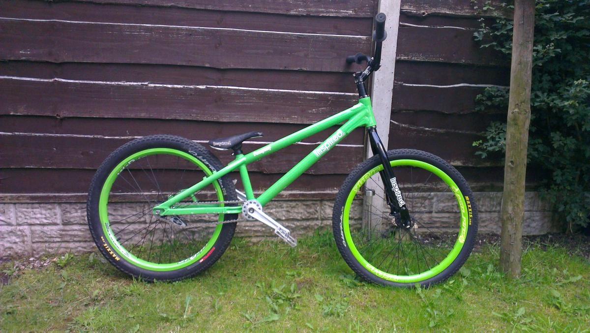

clerictgm Posted December 11, 2012 Report Share Posted December 11, 2012 (edited) SOOOOO.. Help me please with my problem: how many stackers I need with trialtech 70-35 stem, trialtech high rise bars and element frame if I 5.97 ft tall (182cm). Now I have 3cm of stackers and it's max that I can set with sawed-off (222mm instead of 235) steerer tube on my inspired forks. Is it ok or more stackers would be better as said in the beginning of this topic? Now I know one thing - with this bars(30mm stackers, bionic riser) bike was like crap. And what about 70-35 stem? Isn't reach too short? Now with onza 100x30 stem my bike looks like: Edited December 11, 2012 by clerictgm Quote Link to comment Share on other sites More sharing options...
