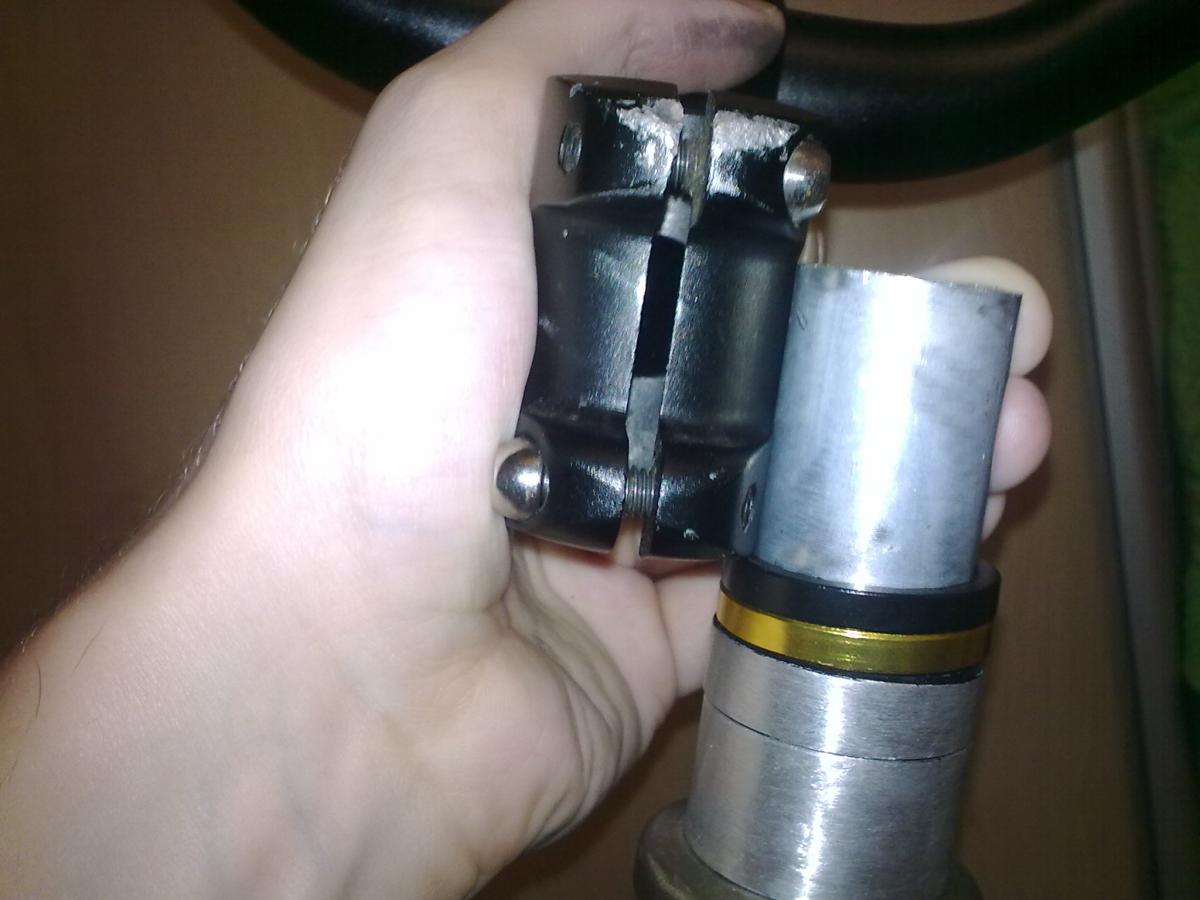

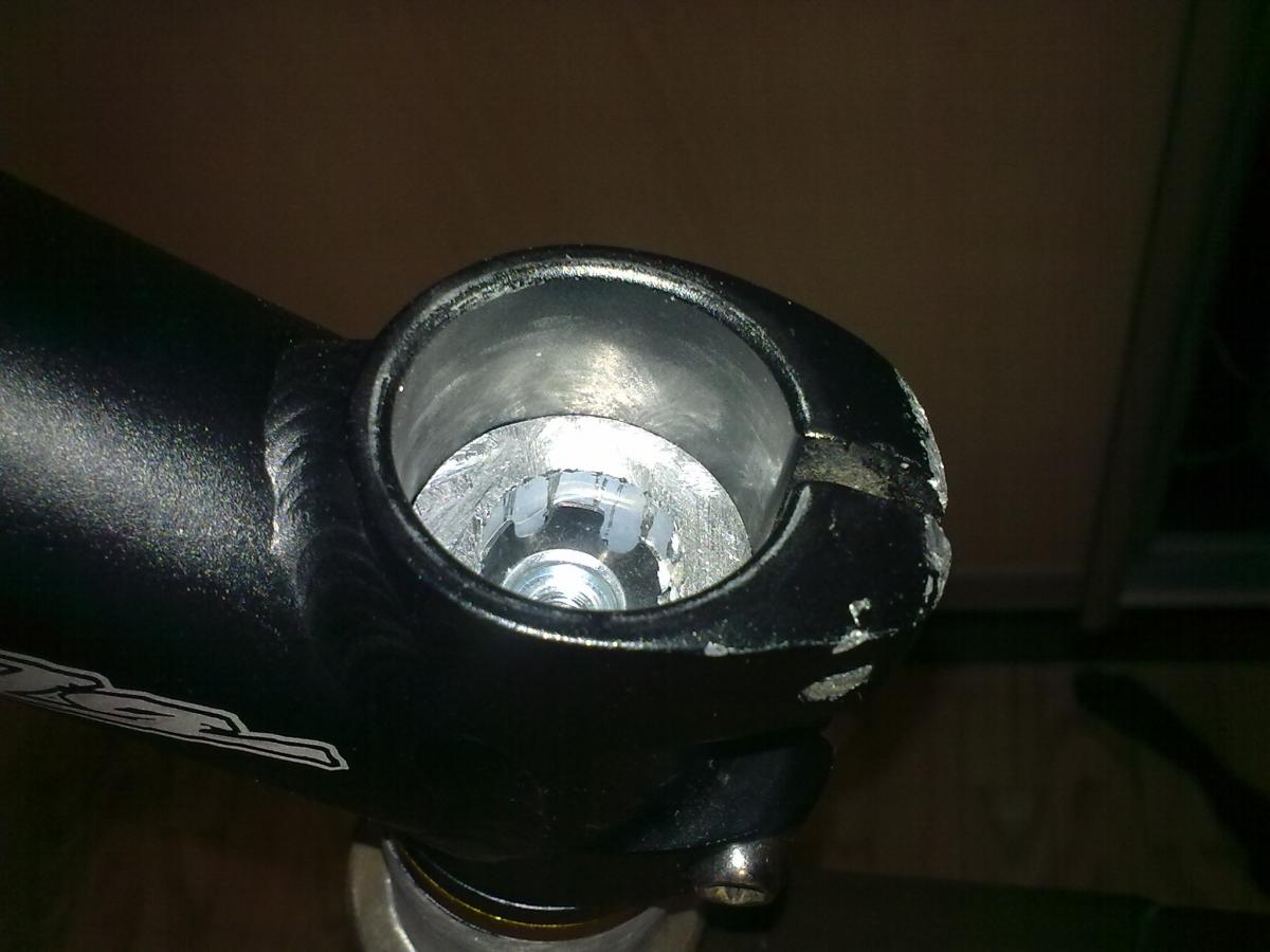

Mark W Posted November 29, 2011 Report Share Posted November 29, 2011 No, nothing like that. Adam made it for me on the lathe here - it's basically a 'ring' that adds the height, and is held in place by having a sort of plug screwed through it, which then tightens into the threaded section on my Inspired forks. My headset preload bolt tightens into the plug itself, so basically it's all held in place nice and tight. There's not really much to see - it just looks like there's a line going around my steerer tube at one point (naturally it has to be flush with the rest of the steerer so my stem slides over it). Quote Link to comment Share on other sites More sharing options...
monkeyseemonkeydo Posted November 29, 2011 Report Share Posted November 29, 2011 On 11/29/2011 at 8:18 PM, Mark W said: No, nothing like that. Adam made it for me on the lathe here - it's basically a 'ring' that adds the height, and is held in place by having a sort of plug screwed through it, which then tightens into the threaded section on my Inspired forks. My headset preload bolt tightens into the plug itself, so basically it's all held in place nice and tight. There's not really much to see - it just looks like there's a line going around my steerer tube at one point (naturally it has to be flush with the rest of the steerer so my stem slides over it). Ah fair enough, sounds pretty bomb proof to be fair doing it like that. Probably stronger than it was before if the plug is as I imagine it. Quote Link to comment Share on other sites More sharing options...
Mark W Posted November 29, 2011 Report Share Posted November 29, 2011 Indeedy. It also works pretty well as I run my headset over-tight, and usually I annihilate every starnut type setup I use. No such issues with this, which is nice Thanks again to Ads Quote Link to comment Share on other sites More sharing options...
chris4stars Posted November 29, 2011 Report Share Posted November 29, 2011 (edited) On 11/29/2011 at 8:08 PM, monkeyseemonkeydo said: I find the more scary thing about that setup is the fact the steerer was extended to allow that many stackers to be used... That just sounds so wrong to me! FamilyBiker- what bike do you ride? Why do I get the feeling you're actually a proper street rider rather than a trials rider? it wasnt extended - that was the length of the steerer before cutting. i cut it, then decided to reattatch when i wanted more rise (after seeing the likes of mr rowlands setup etc) i refer back to the original post i made showing his, im sure its more than mine? and ive seen plenty of others with around 4cm... * edit * just read the post below this - this is exactly what i did with a random topcap i had. only difference is that i used the original cut off piece, and not a piece off another fork so it fit together nicely Edited November 29, 2011 by chris4stars Quote Link to comment Share on other sites More sharing options...
Ali C Posted November 29, 2011 Report Share Posted November 29, 2011 I (did) have a less complicated version where I just cut off the threaded section of an Inspired topcap, threaded that so half the threads were in my forks and half were sticking out the top (loctited in) and then used a small section of fork that had been cut off another pair and screwed that onto the exposed thread. worked great! I extended it by about 10mm and never had any issues. Quote Link to comment Share on other sites More sharing options...
monkeyseemonkeydo Posted November 29, 2011 Report Share Posted November 29, 2011 On 11/29/2011 at 8:24 PM, chris4stars said: it wasnt extended - that was the length of the steerer before cutting. i cut it, then decided to reattatch when i wanted more rise (after seeing the likes of mr rowlands setup etc) But it was extended back to the original pre-cut length, if you get me. The steerer wasn't one piece in the end, which would worry me! Quote Link to comment Share on other sites More sharing options...

chris4stars Posted November 29, 2011 Report Share Posted November 29, 2011 On 11/29/2011 at 8:26 PM, monkeyseemonkeydo said: But it was extended back to the original pre-cut length, if you get me. The steerer wasn't one piece in the end, which would worry me! fair enough - i ran for a good while though with forks before those with the stem barely clamping on to much more than it is in that pic - there was about a cm or so of no steerer and that never hinted at showing an issue! retrospectively id not use that now, but it was fine the forces involved with the extention as it is just wouldnt effect the steerer, the stem clamp would have to snap before the steerer went if you get me?! Quote Link to comment Share on other sites More sharing options...
FamilyBiker Posted November 29, 2011 Report Share Posted November 29, 2011 i meant this.. Quote Link to comment Share on other sites More sharing options...

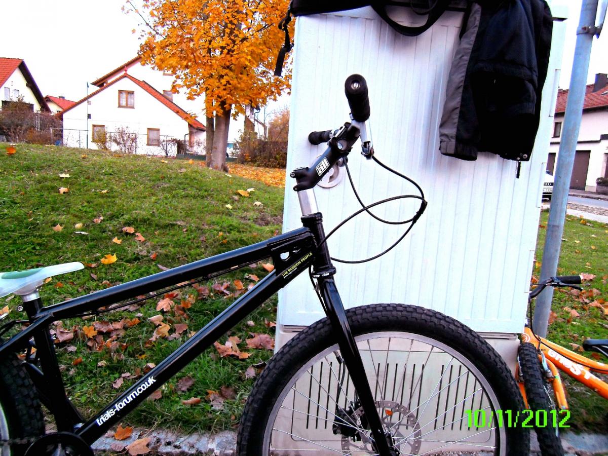

FamilyBiker Posted November 29, 2011 Report Share Posted November 29, 2011 (edited) @monkeyseemonkeydo:my bike´s the marino 24 in the bike pics section.street frame converted to-well it has skye geo,but 365mm chainstays. will be replaced soon by a 360 chainstay 1020 wheelbase frame,and to go for more trialsy stuff a dedicated trials one. btw,i finished the rebuild of a dualdrive hub to singlespped recently.has 72 clicks now (8pawls)and 560g. unfortunately its 36h,wich makes the rim choice harder. i extended a steerer with an aluminium tube and the cutoff part from shortening the steerer. heated the steel steerer and cooled down the alu thingy to -35° with nitrogene,then put together with nice little hammer strokes. THIS is forever. named cryofit,but i wouldn´t call it that haha ali your solution reminds me of the good old LEGO or CONSTRUCTA sets.awesome(just kidding) Edited November 29, 2011 by FamilyBiker Quote Link to comment Share on other sites More sharing options...
