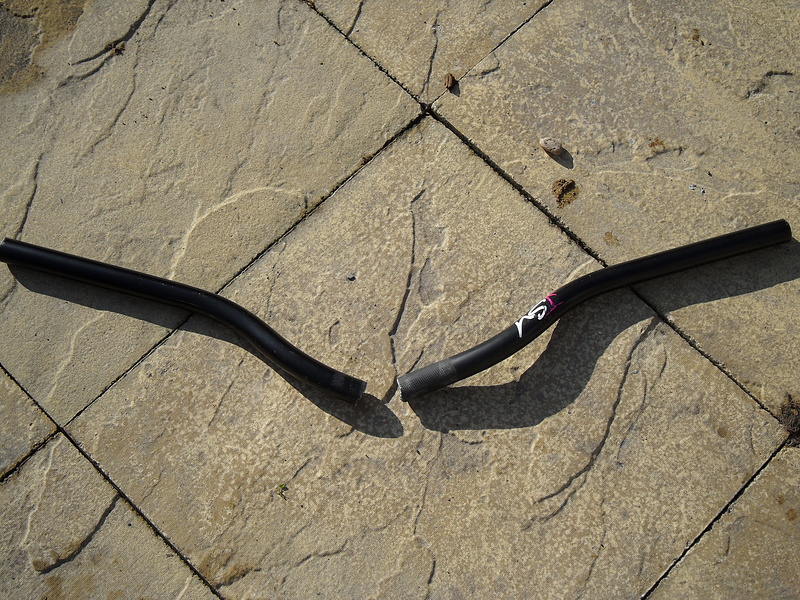

i even dont wanna know how he looked after this happened...
?post-30389-0-23309000-1322571578_thumb.j
...probably snapped,too
those look like the alloy Ns bars (Mint?). Alloy bars with a 25.4 clamp never strike as much confidence in me, 31.8 all the way! 22.2 is fine in steel though, the NS district bars seem the best out there at the moment.
i HAVE to tell it to you,though i hate to say it(cos i wanted to buy them,too):
these are district bars!
the preload thing is probably because when comprimating(i hope this word really exist) and pulling then to gain height you get a serious ammount of bending force into the bars.and no matter if its alu or steel,many few have an elastic module of more than 8-15%,wich together with tensile strength is fundamentalfor the bars holding up or not. there can be dynamic forces at around 2k newton each end of the bar (90kg rider,700mm bar(lever 300-330,depending on stem clamp,means pulling force aprox. 400N/grip)

after a quick google, those do seem to be District bars, they also seem to be the 2009 model, 3 years is old for any bars let alone ones put up to street use. I wouldn't use one photo as a reason not to get bars, I still think they are the best steel bars out there.
