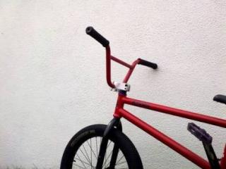

Andeee Posted November 13, 2011 Report Share Posted November 13, 2011 To replicate the steering on a bmx? due to bmx's having high bars so the need for extra stackers gives more height to it. Quote Link to comment Share on other sites More sharing options...

Revolver Posted November 15, 2011 Report Share Posted November 15, 2011 There's also the fact if you did use, say, 24" BMX bars, they'd feel shit for trials, and on top of that, because the bars themselves are big when you change the angle it'd radically change how far forwards the bars are. Quote Link to comment Share on other sites More sharing options...

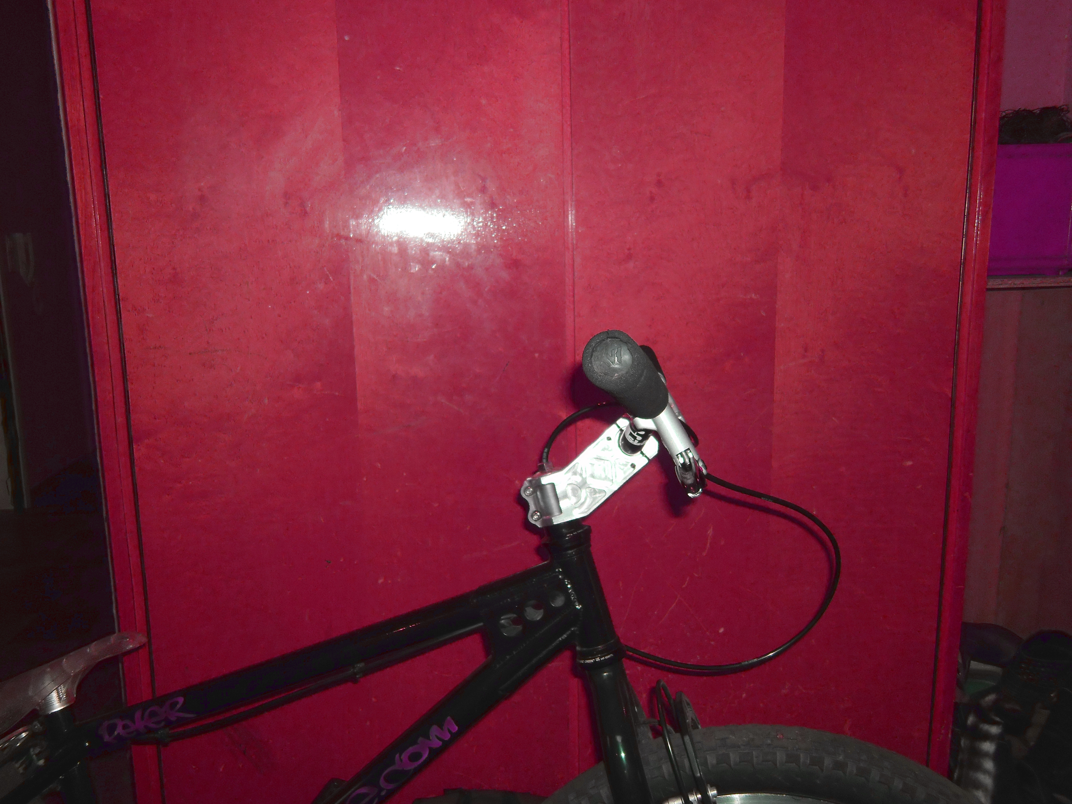

Mark W Posted November 15, 2011 Report Share Posted November 15, 2011 I'd quite like some slightly higher rise bars with less upsweep. BMX bars or bars like the NS Bikes District bars fit the bill reasonably well, but non-dick stems become the issue then. Sort of tempted by some Atomlab bars as they look like they'd offer a little more rise than the TT bars but have 3° less upsweep. Shit Photoshop ahoy: And these are the District bars for comparison. Matt - I guess you've got to bear in mind that most trials bikes are set up to 'feel nice on the back wheel', so a lower front end keeping your body weight orientated slightly more over the bars generally helps that (as it keeps everything more in line in a backhop position). With a 24 you usually need a more neutral body position, so you need to bring your front end up higher to keep your body weight back. This helps loads for bunnyhops and manuals, which are two fairly popular things as far as 24" riding goes. Quote Link to comment Share on other sites More sharing options...

FamilyBiker Posted November 16, 2011 Report Share Posted November 16, 2011 i´ve never ridden anything trialsy when it comes to handlebars,my opinion is that steel is reliable. got this 100x25 stem,and a 35mm rise bar made of 4130. the only thing i´d change would be the rise,3" would be good. upsweep changes to "forward sweep" (i´d call it),when the bars are rolled forward,i think the less of it,the better. going for atomlab too. i think mark´s right,bike mechanics are always...(am one,too lol) Quote Link to comment Share on other sites More sharing options...
