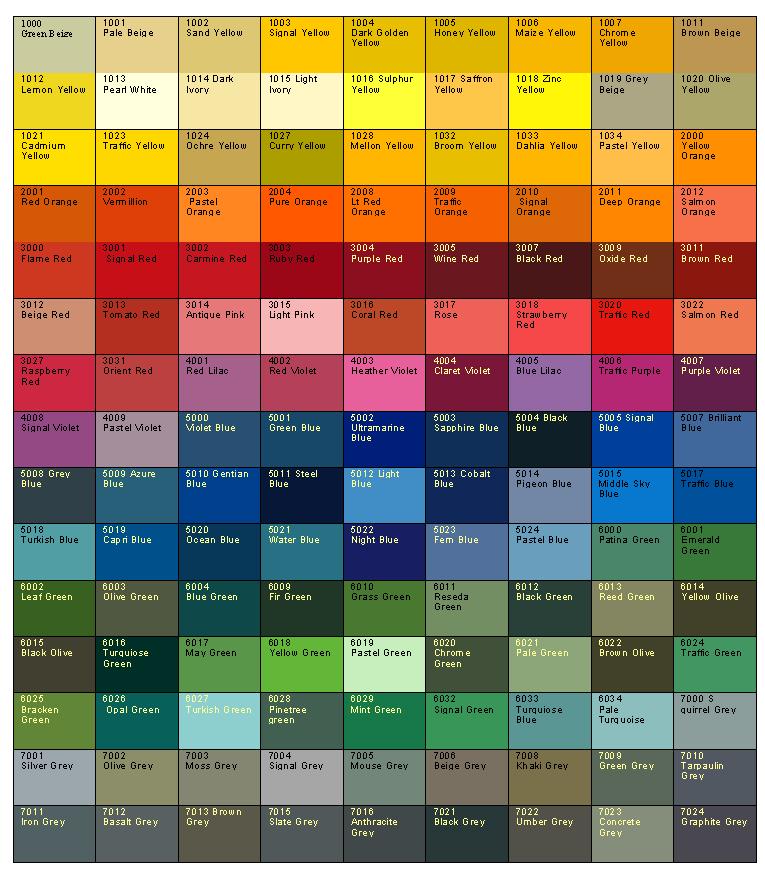

TrialsIsHard Posted November 13, 2011 Report Share Posted November 13, 2011 (edited) There's a powder coaters down my way, who apparently have many many colours. http://www.touchtunbridgewells.com/business/list/bid/751877 Also here is a picture of all (I think) colours that you can get powder coated. Hope that helps Edit: Also isn't the colour you're looking for, the same as that new Rockman frame proto? I was wrong, but it's this colour? http://www.facebook.com/photo.php?fbid=1850924157215&set=t.1364087477&type=1&theater Not sure if I should post links to peoples facebook without permission but, it's a nice colour Edited November 13, 2011 by TrialsIsHard Quote Link to comment Share on other sites More sharing options...
chris4stars Posted November 13, 2011 Author Report Share Posted November 13, 2011 There's a powder coaters down my way, who apparently have many many colours. http://www.touchtunbridgewells.com/business/list/bid/751877 Also here is a picture of all (I think) colours that you can get powder coated. Hope that helps Edit: Also isn't the colour you're looking for, the same as that new Rockman frame proto? I was wrong, but it's this colour? http://www.facebook.com/photo.php?fbid=1850924157215&set=t.1364087477&type=1&theater Not sure if I should post links to peoples facebook without permission but, it's a nice colour yes - thats exactly the colour, the photo of his frame above the trophies shows it pretty much perfectly! ive no idea why it is seemingly impossible to find, but i'll keep looking looked through various ral and those other 'bs' number charts with nothing coming close at all...with lime green being being quite popular quite a few other areas recent (almost fashionable) im surprised this is the case! Quote Link to comment Share on other sites More sharing options...
TrialsIsHard Posted November 13, 2011 Report Share Posted November 13, 2011 Lime green is really easy to get, that shade however probably isn't. Contact rockman and see how it's coated and which colour number it is? Might get you moving in the right direction Quote Link to comment Share on other sites More sharing options...
