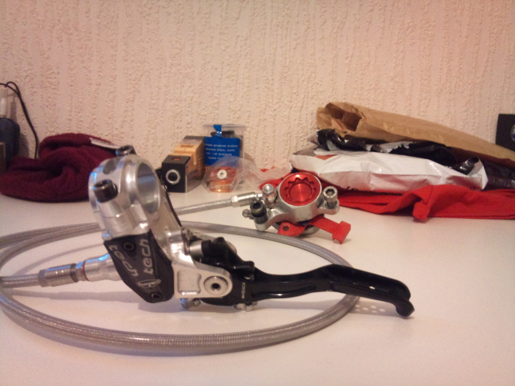

Joshm1991 Posted November 10, 2011 Author Report Share Posted November 10, 2011 Is the Hope brand new? Is it definitely a Mono/Tech Trial (not an X2)? It's not BRAND new but the guy said it has just had new pads and said it was in "excellent condition"!! The only reason he removed it was because he got a team green one!! Heres a picture of it so you can decide what it is for me!! Cheers Joosh Quote Link to comment Share on other sites More sharing options...
AdamR28 Posted November 10, 2011 Report Share Posted November 10, 2011 It's a Tech lever, with a Trial caliper, but looking at the state of the bolts and the fact that the bore cap has been changed, I wouldn't say it's all that new. Probably fine but if the rotor or pads are a bit shagged it won't work well at all (which is the problem with most used Hope brakes). Quote Link to comment Share on other sites More sharing options...
