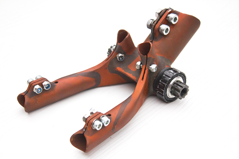

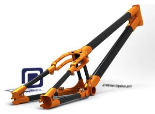

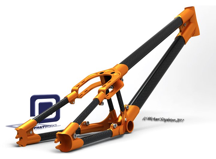

Phatmike Posted October 23, 2011 Report Share Posted October 23, 2011 Hey guys, It's been 2 years now since the idea was conceived, and with much head scratching, sweat and blood over my final year at Loughborough Uni I built the first prototype. 6 months of concept and rigid design, 3 weeks lathing, plus another month of fabrication and one late night rush of assembly, the ridable proto was made following the dimensions of the CAD model: There was a topic with a few people talking here; And I wanted to answer a few questions about it. On 5/28/2011 at 8:03 PM, Revolver said: The idea is, if you break a tube, you swap it, and if you want to change the geometry, you have means to. Exactly, the whole system is modular. The tubes are easy to replace with an allen key (though changing the downtube does mean disassembling most of Phrame), meaning not only can you replace parts and change geometry, you can also upgrade components. Want disk mounts? No problem: Just buy a single replacement dropout. On 5/27/2011 at 3:50 PM, Jo Prattley said: surely if the tubes are clamped the frame will flex more ? I spent a couple of months researching tube joining methods, and settled on the pinch bolt clamp. There's one other clamping method I want to try, but Phrame is incredibly stiff - it was designed to maximise lateral stiffness (or twisting when you pedal), with a delicious amount of spring and pop vertically. Thanks to all the pro riders that helped in discussion with that! On 5/27/2011 at 3:53 PM, isitafox said: The rear brake mounts look familiar. Isn't that how alex dark designed his frame?? Yeah. Hoffmann bikes released a frame with that system a few years back - always liked it and was glad for the chance to include it in a design. The result: It's awesome. No other brake feels quite like it. On 5/28/2011 at 9:57 PM, LukasMcNeal said: This is amazing it could kill all other frames! If this worked theoretically you would never have to buy another frame again! That's kinda the point. On 5/29/2011 at 9:48 AM, Greetings said: I'm not sure weight could be a selling point, especially with all the light Koxx's and the recent 1.2kg Echo stock frame. Frames in trials are getting more and more disposable - ride it a bit, break it, get something else. And this is why.. Phrame is also a way of breaking that throwaway cycle. On 5/29/2011 at 9:11 AM, Skoze said: I really like the idea, but i can see breaking and replacing downtubes (and probably chainstays) getting pretty expensive? Cheaper than getting a new frame every time a crack appears! All the tubes on Phrame are readily available diameters, meaning you could replace them with Steel, Alu, CF, Bamboo.. alsorts. Straight gauge tubes are pretty cheap too. On 5/29/2011 at 9:34 AM, Greetings said: I can't see how it's possible to change the geometry by just installing shorter/longer tubes. You'd need to replace the connecting bits too which essentially means replacing most of the frame. As Krisboats said in the previous topic, varying geometries would require bent tubes. Each geometry and tube bend is calculated via a CAD model and then the tubes can be precisely bent before being verified in a jig. There's a lot of interest around the concept (especially to those who said it wouldn't work ), and as part of a commitment to open-source info, I'd be glad to share my research and info with interested individuals and organisations. I'll keep the thread updated with more images.. I am looking to partner up with help to see the project to light. Be it by way of pre-sales, or assistance in the development and commercialisation phase. It'll be a fun project nonetheless. M. 2 Quote Link to comment Share on other sites More sharing options...

Phatmike Posted October 23, 2011 Author Report Share Posted October 23, 2011 As I said, it's still at the functional prototype stage - the rest is intention! It's also a rare opportunity in the sport to have such an innovation developed openly rather than behind closed doors. Each of the components would easily, readily available, for a fair cost. This isn't a money making venture (it's trials...) more an exercise of communal technical development. As for colours, any colour under the sun at this stage! Here's a pic: Only proper one I got before it was submitted and subsequently de-built. Once I can afford spokes for my own bike, I'll get this one built up for further refinement. 2 Quote Link to comment Share on other sites More sharing options...

monkeyseemonkeydo Posted October 23, 2011 Report Share Posted October 23, 2011 On 10/23/2011 at 1:43 PM, onza1 said: Are the pieces made out of carbon!?!?!? The carbon looking tubes are carbon tubes, the machined looking (orange) bits are metal (aluminium or welded steel I'm not sure). On 10/23/2011 at 2:11 PM, Adam@TartyBikes said: How tricky was it to assemble? Lots of jiggling and waggling I bet! Following on from that, how tricky is it get it all straight and aligned? Without a jig it must be an interesting problem! Can I ask what sort of weight the final proto has ended up at? Quote Link to comment Share on other sites More sharing options...

Phatmike Posted October 23, 2011 Author Report Share Posted October 23, 2011 Aye, things like bb30, bolt through rear end, 1.5 taper headtube (which this has) can all be worked either into the original purchase, or available as after-market accessories. The intention is to make it open-sourced, so DIY enthusiasts, or companies can all provide accessories to go with it. (How about a downtube/bb junction with a battery and motor in it? Ad, yeah this was the one I called up for parts for! Managed to borrow everything else I needed to make it look alriight. On 10/23/2011 at 4:05 PM, monkeyseemonkeydo said: The carbon looking tubes are carbon tubes, the machined looking (orange) bits are metal (aluminium or welded steel I'm not sure). Following on from that, how tricky is it get it all straight and aligned? Without a jig it must be an interesting problem! Can I ask what sort of weight the final proto has ended up at? The Carbon looking tubes are Alu, as is the rest of it. S'all 6082/6061 T6. Yeah, jigging it up took quite a while. We had the dropouts/bb shell/headtube aligned in a jig that Josh made, then held the various pieces and built it all up with the tubes in place. Will get a weight up when I find some scales, although I believe it's in the 4.5lb area. That's something that can easily brought down (to any level..), but I was happy with that with the first proto! The BB yolk: Quote Link to comment Share on other sites More sharing options...
