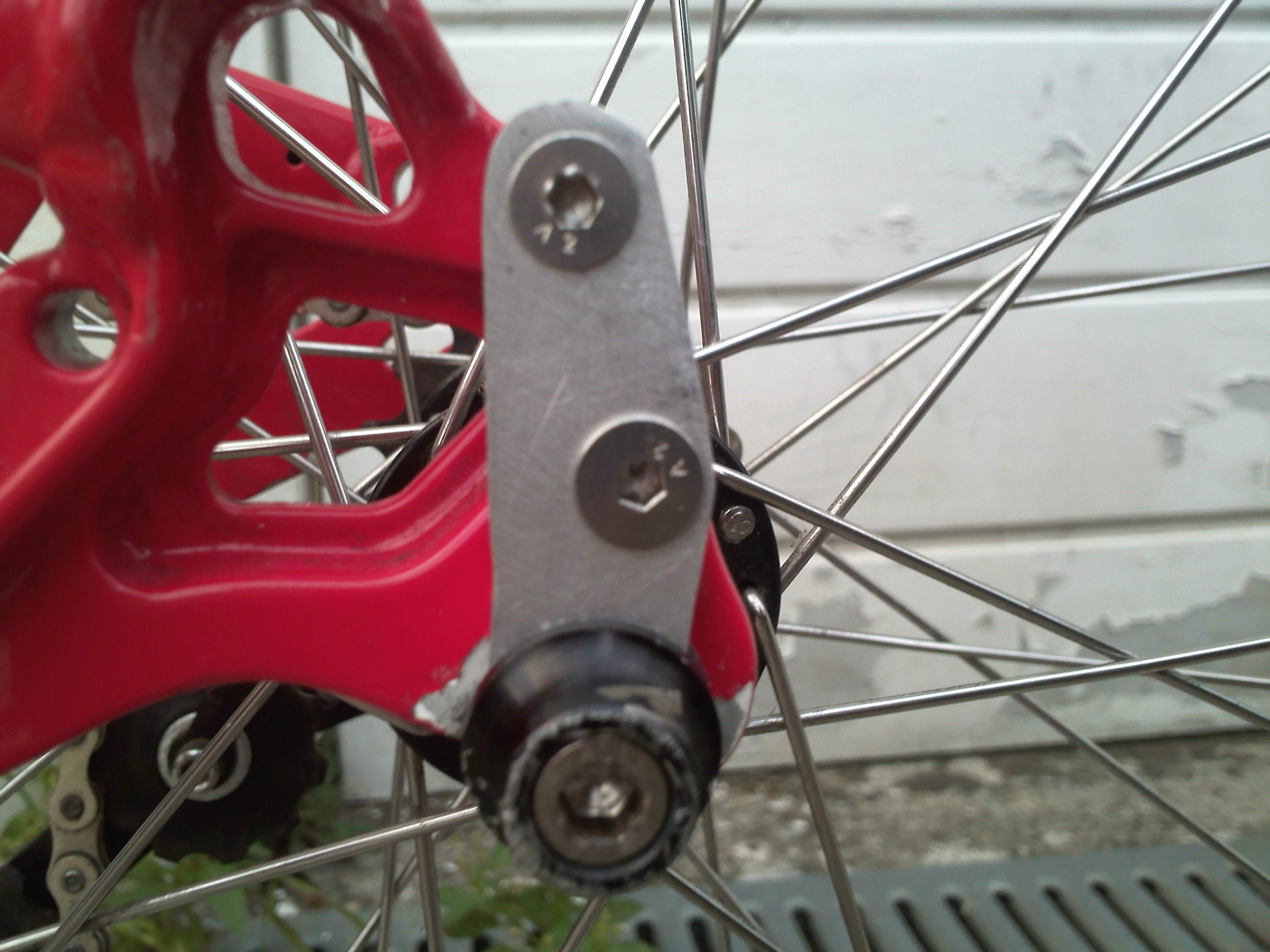

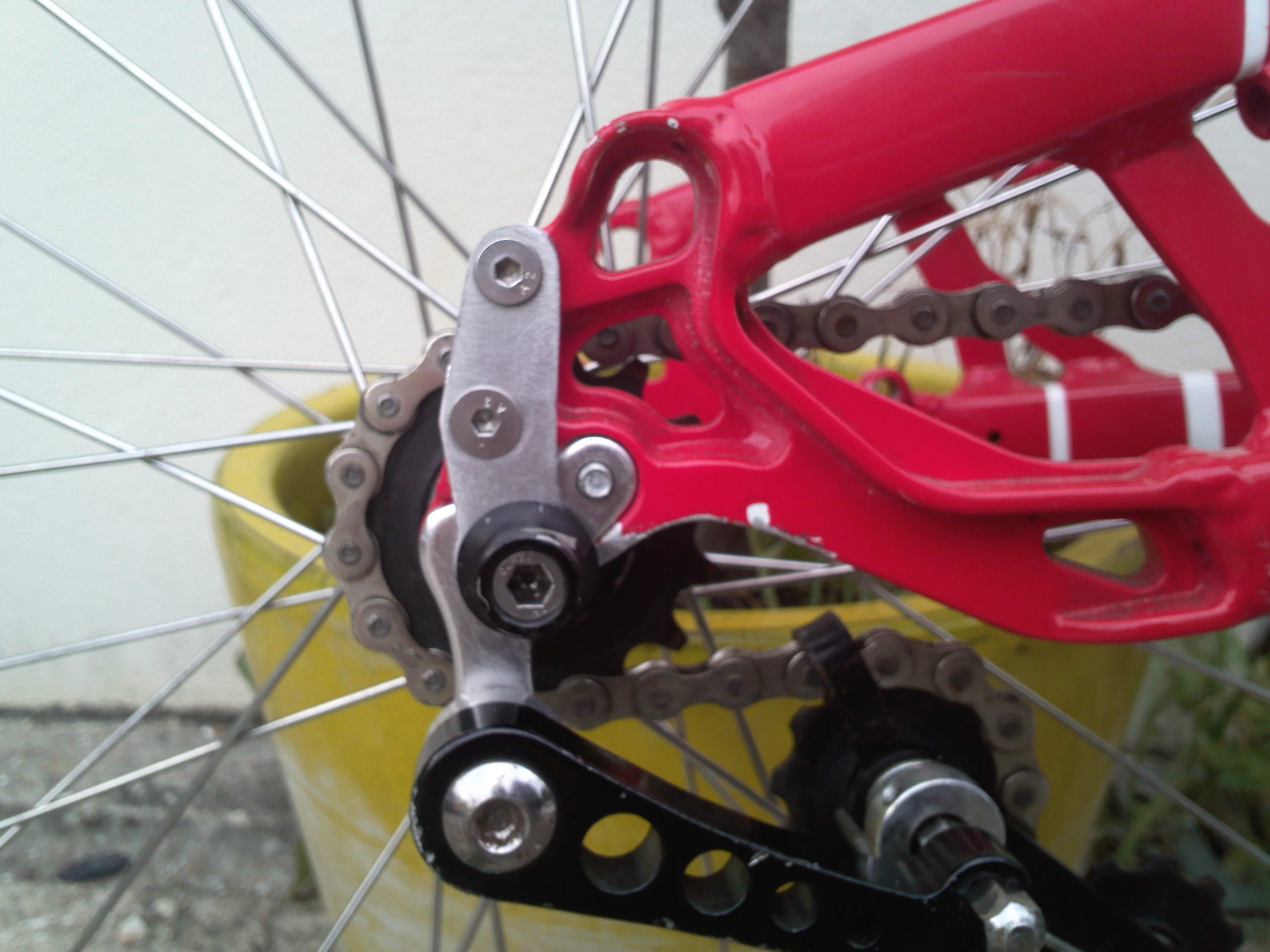

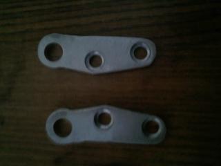

Culshaw95 Posted October 10, 2011 Report Share Posted October 10, 2011 Hi i was just wondering if there are any riders with the Ashton/Diamondback 26" and if so i was wondering if they have had any problems with their rear wheel slipping out of place. I have had this problem since i got the bike and i have come up with a design and it has been made and tested to stop the rear wheel coming out Quote Link to comment Share on other sites More sharing options...

Culshaw95 Posted October 10, 2011 Author Report Share Posted October 10, 2011 I have one, and I solved it by adding small spacera each side on my tryall h hub and smear revolver and just got fresh bolts and done them up tad tighter then usual nd never does it. Fair play to you for trying just looks major bulky and horrid on them though na its not to bad when you actually see it. I just started to get annoyed with the bike cause i have come of many times from it coming out of place so i got it made but i have grown a lot more confidence with them oni just never understood why it slipped out i always checked it had no grease on the axle and tightened it and then the other day not only did it come out it snapped the axle bolt aswell. I just thought it would be worth putting on just to see what people would say cause it has worked out pretty well Quote Link to comment Share on other sites More sharing options...

Culshaw95 Posted October 10, 2011 Author Report Share Posted October 10, 2011 If it slips out then thats a fault surely? Is this on the diamond back frames? well when i got the bike off tartys i told them about it and they said "Sounds as though you have it not quite tight enough or it isn't installed correctly. Please ensure the hanger and tensioner are all setup correctly. A good way to do this is to sit on the bike backwards as you tighten the bolts, so the axle is all the way into the dropouts." i got it set up properly down my mates and he had a go and it came out again when it was tightened up Yeah George has mentioned that you had issues with yours, thought I was the only one with a Ashton, o think its just a flaw in the frame but when I sorted mine hasn't caused me any issues. ah right well its all sorted now haha and i might be coming up MK for like a week in the summer next year bringing the bike up just to ride with new people and ride a new area Quote Link to comment Share on other sites More sharing options...

Culshaw95 Posted October 20, 2011 Author Report Share Posted October 20, 2011 I never had this problem with my ashton, but I used a hope trials hub. I rekon Ali is right, just file some of the axle off either side? I never had this problem with my ashton, but I used a hope trials hub. I rekon Ali is right, just file some of the axle off either side? Yeah but i have made that part thats what the whole post is about its showing how i solved the problem. I wanted to see what people thought of it but people are just saying ideas of how to stop it when its stopped Quote Link to comment Share on other sites More sharing options...

Culshaw95 Posted October 27, 2011 Author Report Share Posted October 27, 2011 its not made it any harder to remove the wheel, you don't have to take the whole adapter off you just take the axle bolts off thats it Quote Link to comment Share on other sites More sharing options...
Matt Vandart Posted October 27, 2011 Report Share Posted October 27, 2011 I think that its cool, It may make your drop outs stronger. Quote Link to comment Share on other sites More sharing options...
