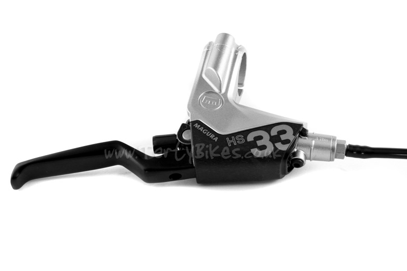

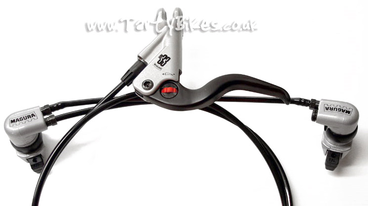

Warranty lasts one year. If your brake is older than that, water bleed it.
Personally I think it's a waste of antifreeze to do an antifreeze bleed in the bath but that's your call.
Which model brake is it?
