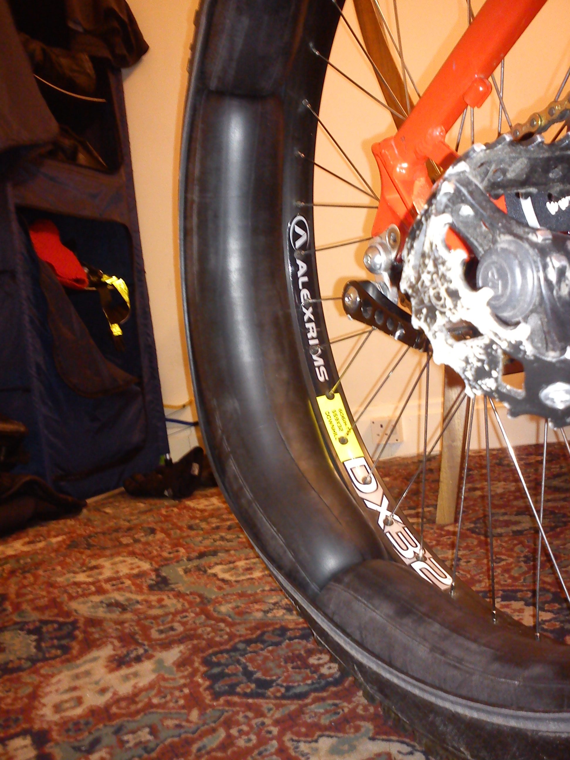

Joshm1991 Posted September 25, 2011 Report Share Posted September 25, 2011 (edited) Got a Schwalbe Big Betty of my mate for nowt cos he got some new ones!! He warned me they were a bit iffy to sit on the beads but I never thought it was this bad!! (BTW - this has been left for about 2 hours before I took the picture) Reckon a DH tube will fix it?? Joosh EDIT: Apoligies for the picture being mahoosive!! Edited September 25, 2011 by Joshm1991 Quote Link to comment Share on other sites More sharing options...
Rockman Posted September 25, 2011 Report Share Posted September 25, 2011 Got a Schwalbe Big Betty of my mate for nowt cos he got some new ones!! He warned me they were a bit iffy to sit on the beads but I never thought it was this bad!! (BTW - this has been left for about 2 hours before I took the picture) Reckon a DH tube will fix it?? Joosh EDIT: Apoligies for the picture being mahoosive!! Let the air out the tube, put the bead back on the rim, and slowly pump the tyre up and stop every so often to make sure the tyre is correctly seated on the rim. Quote Link to comment Share on other sites More sharing options...
Joshm1991 Posted September 25, 2011 Author Report Share Posted September 25, 2011 Yeah I did that when I was putting it on.. It looked dodgy then too!! like on bit of the bead was raised up and I think thats where its came off at!! :/ Joosh Quote Link to comment Share on other sites More sharing options...
dann2707 Posted September 25, 2011 Report Share Posted September 25, 2011 Hahaha thats amazing !! Should see if you can hop on it at least. Might make one hell of a pop though Quote Link to comment Share on other sites More sharing options...
Rockman Posted September 25, 2011 Report Share Posted September 25, 2011 Yeah I did that when I was putting it on.. It looked dodgy then too!! like on bit of the bead was raised up and I think thats where its came off at!! :/ Joosh once you notice it looking dodgy, try and push the bead back on, then slowly pump it up checking the bead as you go, should work. Quote Link to comment Share on other sites More sharing options...
