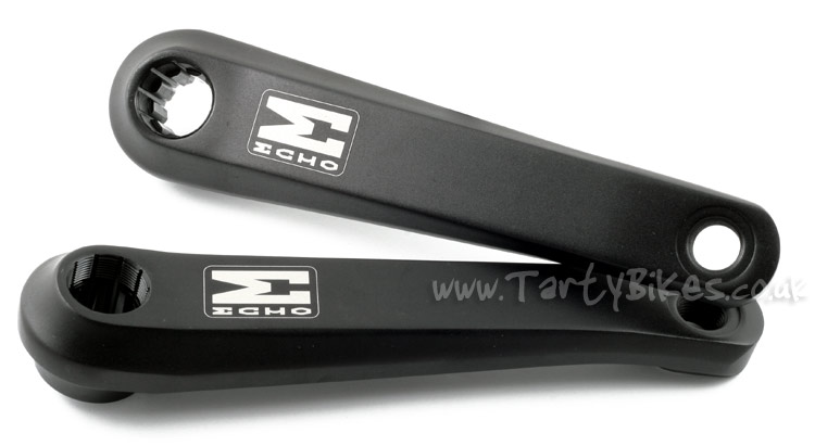

Are These Cranks Isis And What Make Of Echo Are They?
Dave Sutton
Look like the Echo 6061 cranks:
You can work out whether they're ISIS or square taper two easy ways - one is to look at the BB spindle where it start to go into the cranks. If it starts to go from round to having 4 flat edges, then it's square taper (you'll usually only be able to see a bit of this). If it does anything else, it's ISIS. Alternatively, you can take that crank bolt off with an 8mm allen key then look at the end of the spindle inside the crank. Again, square = square taper, a 'star' shaped = ISIS.
