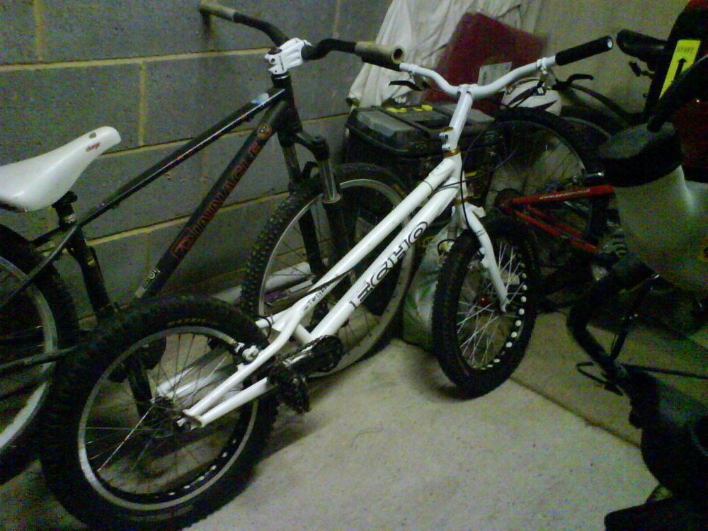

SamKidney Posted August 21, 2011 Report Share Posted August 21, 2011 Had this sat in the garage and thought Id build it up and see what its like. Bought it as a whole bike but stripped it to build my Onza Ice 2. Riding it for this week, or maybe until I get my bleeding kit so I can run the hosing through the Ices Frame. Echo Lite 09 Frame Try-All Forks Trialtech Stem Trialtech Highrise Bar Neon Bow Headset Neon Carbon BB Trialtech Sport Cranks Echo SL Freewheel Neon Light Bashring KMC Z510HX Chain Echo TR Rear Wheel Try-All 20" rim laced onto a Pro2 Magura Hs33 05 x2 Both with Heatsink CNC Yellows Quote Link to comment Share on other sites More sharing options...
