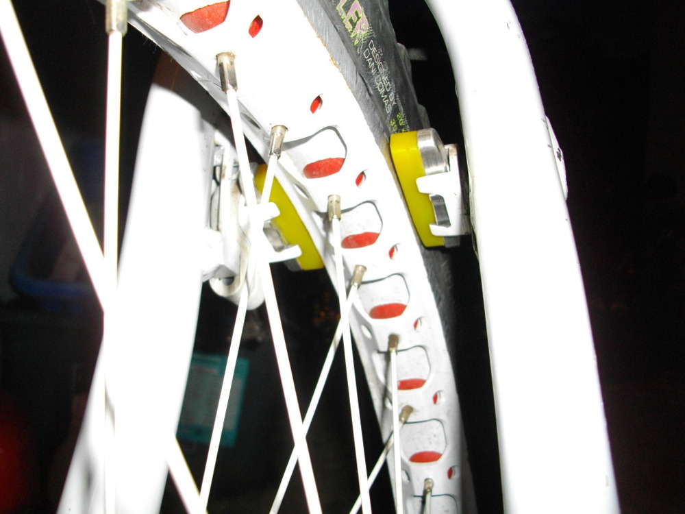

SamKidney Posted August 15, 2011 Report Share Posted August 15, 2011 Hi Guys, Moved to front Magura yesterday and would like help or advice on setup please. The grind on the rim has all but gone, So the question is, whats the best way to go about grinding it? Im fine with grinding the rear, but are there any tips as to what disc to use, light grind ect..... Im running Heatsink CNC Yellows and an Echo SL rim. Cheers, Sam Quote Link to comment Share on other sites More sharing options...
Alex Dark Posted August 15, 2011 Report Share Posted August 15, 2011 Lightest pressure possible, 45* angle with a stone cutting blade Quote Link to comment Share on other sites More sharing options...
Filo Posted August 15, 2011 Report Share Posted August 15, 2011 I grind the front the same as my rear. I love my front brakes 1 Quote Link to comment Share on other sites More sharing options...
p_ruskin Posted August 16, 2011 Report Share Posted August 16, 2011 Metal cutting disk, light-ish grind for heatsinks as they are quite soft. Then just the same as you would for the back one Quote Link to comment Share on other sites More sharing options...
SamKidney Posted August 16, 2011 Author Report Share Posted August 16, 2011 Used a slightly worn stone cutting disc and put little pressure at a 45 degree angle. Light/ Medium Grind. Brake is now awesome Cheers Guys Quote Link to comment Share on other sites More sharing options...
