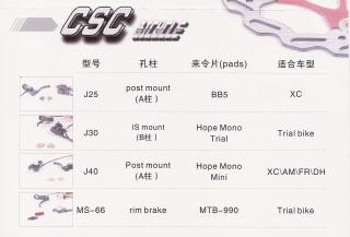

dart89 Posted December 9, 2011 Report Share Posted December 9, 2011 the brake which Alex has tested is the current model J25,as you can see on the attachment , is recommended for XC use, for us it is recommended the J30, it mounts hope mono trial pads! You can see the photos here about the rim brake, I wrote a topic in "NEWS", however you can see the photos here Quote Link to comment Share on other sites More sharing options...
