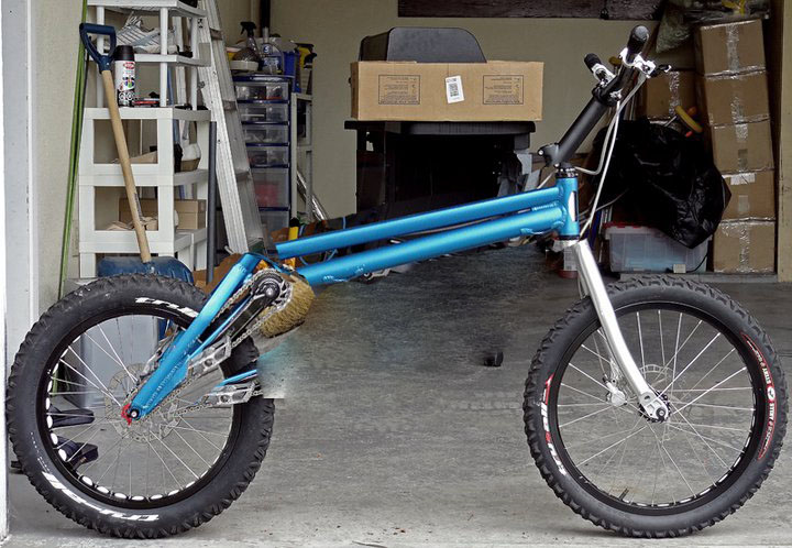

Rusevelt Posted October 19, 2012 Report Share Posted October 19, 2012 Bumping this post to see if peoples views have changed about the idea of a 105bb being more accepted a year on. Quote Link to comment Share on other sites More sharing options...

Laurence--Trials Posted October 19, 2012 Report Share Posted October 19, 2012 I think it looks hidious (spelling?) just doesn't look right atall. Would probally look a bit better if it was on a ozonys curve or a single tube typed design. Quote Link to comment Share on other sites More sharing options...
Laurence--Trials Posted October 19, 2012 Report Share Posted October 19, 2012 (edited) The full geo: Geometry Wheelbase: 1000 BB: 105 Chainstay: 350 Headangle: 71.5 Rear Hub spaced at 116mm Headtube lenght is 110mm Disc mounts: IS type Rear Disc Size: 160mm Weight: 1.20kg and from what i can work out, the original page: http://velotrial.com...новлена/ Edited October 19, 2012 by Laurence--Trials Quote Link to comment Share on other sites More sharing options...

stunt man t Posted October 20, 2012 Report Share Posted October 20, 2012 a few years ago +55 was normal and you would of thought +80 was abit too high, now +80 is normal +105 seems abit too high? i suppose you cant really comment til you try it? Quote Link to comment Share on other sites More sharing options...
