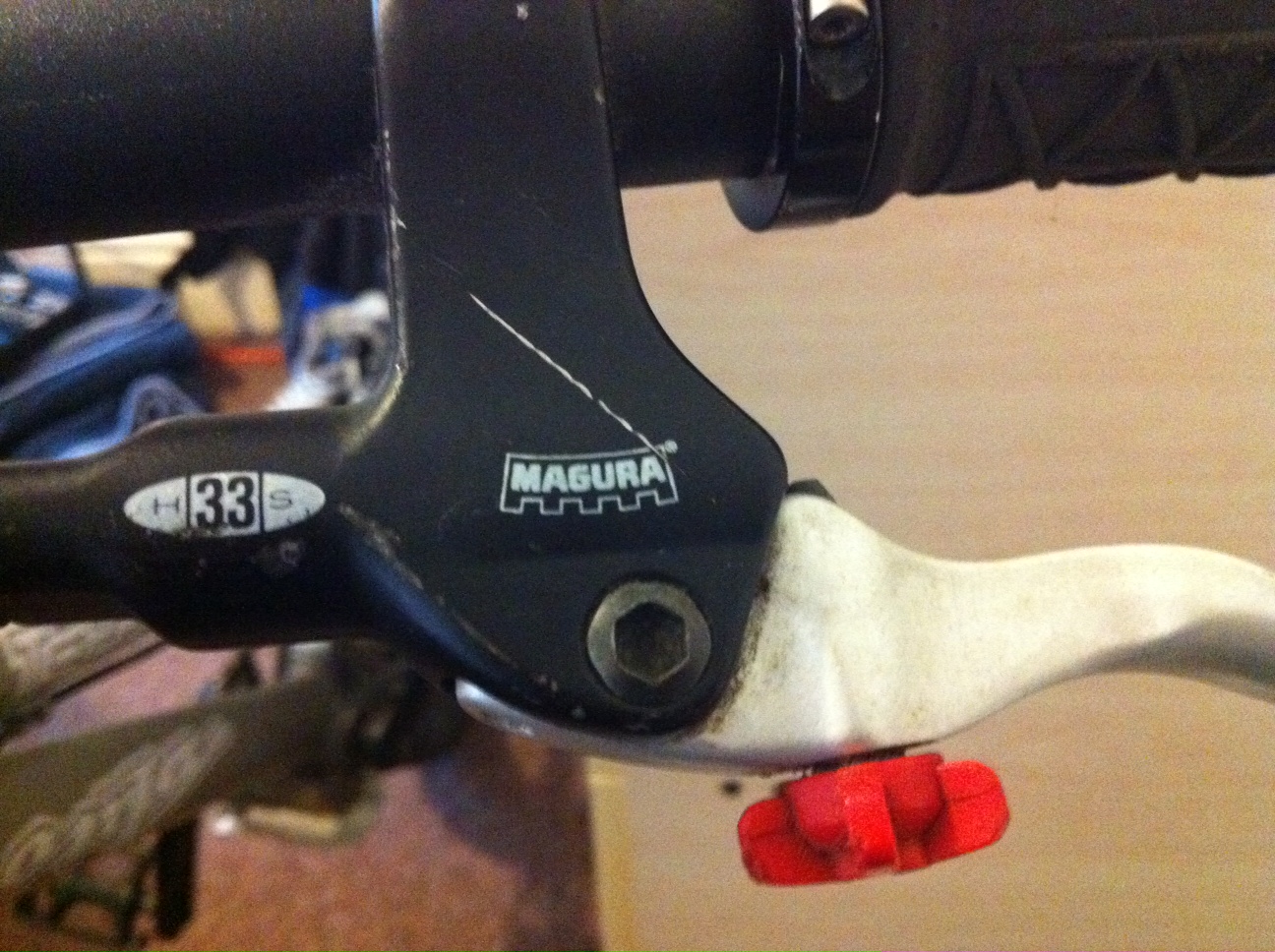

TheSnowden Posted July 16, 2011 Author Report Share Posted July 16, 2011 Also, does anyone know what year these maggies are from and where i can get a replacement screw (the red one i guess to make them match lol) Quote Link to comment Share on other sites More sharing options...

BradJohnson Posted July 19, 2011 Report Share Posted July 19, 2011 Also, does anyone know what year these maggies are from and where i can get a replacement screw (the red one i guess to make them match lol) i think thats an 04 Quote Link to comment Share on other sites More sharing options...
TheSnowden Posted July 19, 2011 Author Report Share Posted July 19, 2011 i think thats an 04 yeah i think so too, cheers anyway mate Update: have learnt how to bleed brakes thanks to Revolver's video, what an amazingly easy process! Quote Link to comment Share on other sites More sharing options...

Mark W Posted July 19, 2011 Report Share Posted July 19, 2011 Also, does anyone know what year these maggies are from and where i can get a replacement screw (the red one i guess to make them match lol) You can use an ordinary M5 bolt to replace the actual broken part of that (it's just the threaded section of the TPA which will have broken). It's possible to get the red adjuster cap on with a bit of tweaking, but I ran mine without them and it was fine. Used to have some beasting long bolts in mine, pure danger... Quote Link to comment Share on other sites More sharing options...
