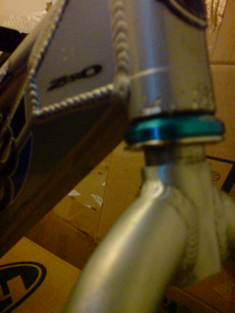

old'scoolfool Posted July 15, 2011 Report Share Posted July 15, 2011 (edited) The Onza Mongo headset crown race is stupid huge and the forks get stuck about 10mm from the crown where the steerer gets a little wider at the bottom, is there another crown race that will fit or am i shit outta luck and need new forks, i've tried fatty's and urban's gets stuck at the same place Edited July 15, 2011 by old'scoolfool Quote Link to comment Share on other sites More sharing options...
AdamR28 Posted July 15, 2011 Report Share Posted July 15, 2011 Either: - Use a crown race setting tool (big tube that you can slide down over the steerer to hit the crown race on equally) - Use some grease - Cut through the crown race so it's split, will then go on easier (still works fine, in fact better than standard IMO) Quote Link to comment Share on other sites More sharing options...
old'scoolfool Posted July 15, 2011 Author Report Share Posted July 15, 2011 (edited) Either: - Use a crown race setting tool (big tube that you can slide down over the steerer to hit the crown race on equally) - Use some grease - Cut through the crown race so it's split, will then go on easier (still works fine, in fact better than standard IMO) wow that was quick thanks i wonder if a seatpost and hammer will duplicate as a crown race tool, i'll let you know when i break them lol Edited July 15, 2011 by old'scoolfool Quote Link to comment Share on other sites More sharing options...
Revolver Posted July 15, 2011 Report Share Posted July 15, 2011 I always split crown races now, it's so much easier. You can slide them on with your hands. Quote Link to comment Share on other sites More sharing options...
AdamR28 Posted July 15, 2011 Report Share Posted July 15, 2011 wow that was quick thanks i wonder if a seatpost and hammer will duplicate as a crown race tool, i'll let you know when i break them lol Maybe - if you can find a massive seat post. Quote Link to comment Share on other sites More sharing options...
