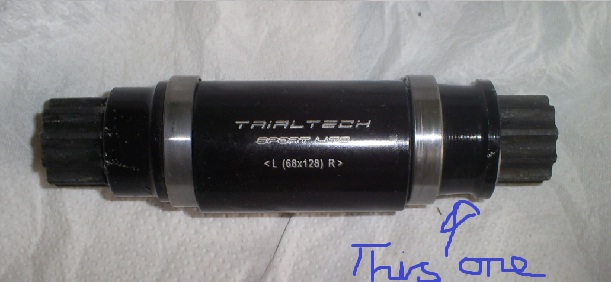

I had another look and have now realised that I didn't look at the spacer between the bash and the bottom bracket, it's bent. On the non-drive side the bottom bracket bit where the left crank goes look straight. It's the spacer that seems to have gone at a weird angle and I can't get it off. Any ideas?

Anyways, I've removed the BB and found the the big bit in the middle that says Trialtech on it is wobbly that shouldn't be. What does this mean?
Also how do I get the spacers off to look? They're on there pretty tight...Also the highlighted one is the one that's bent.
