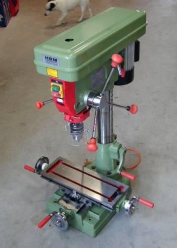

Maxx Posted June 16, 2011 Report Share Posted June 16, 2011 Hi, I want to make bigger holes in my front rim and don't want to spend too much time to make it with file, drilling machine, ... I search for milling machine but all I find is that type of machine : It's expansive and not what I want because it's not portable. I want this : But somebody know what's the name of this ? Thanks, and sorry for my bad english ... Quote Link to comment Share on other sites More sharing options...

Maxx Posted June 16, 2011 Author Report Share Posted June 16, 2011 I want a machine for making bigger holes but also for other things (not necessarily in touch with bike). So don't want milling machine, too expensive. Router table, why not I saw some which were not too expensive. But where can i get a router bit for aluminium ? They are all for wood. For the tungsten carbide rotary file, how did you use it ? With a drilling machine ? I thought about the Dremel but I don't know if it's rather resistant for this kind of thing. Quote Link to comment Share on other sites More sharing options...
