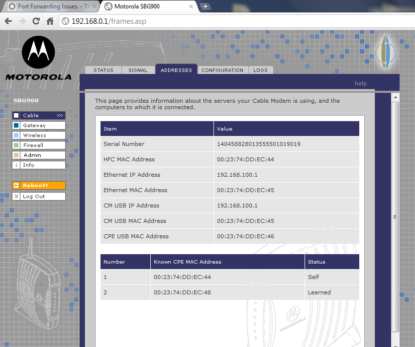

post-4715-0-73544100-1305584602_thumb.pn
That's all I see.

Is the Voange connected at the moment? To me that looks like the list of associated MAC addresses - one being the router itself and the other presumably being the computer you're connected with...
When i took the screenshot it was conected and working to the router via it's ethernet port.
Weird - I would have expected it to show up, but regardless, that page isn't showing the IP address of the current connected device, so isn't much use. Is there anything useful under Gateway->LAN?

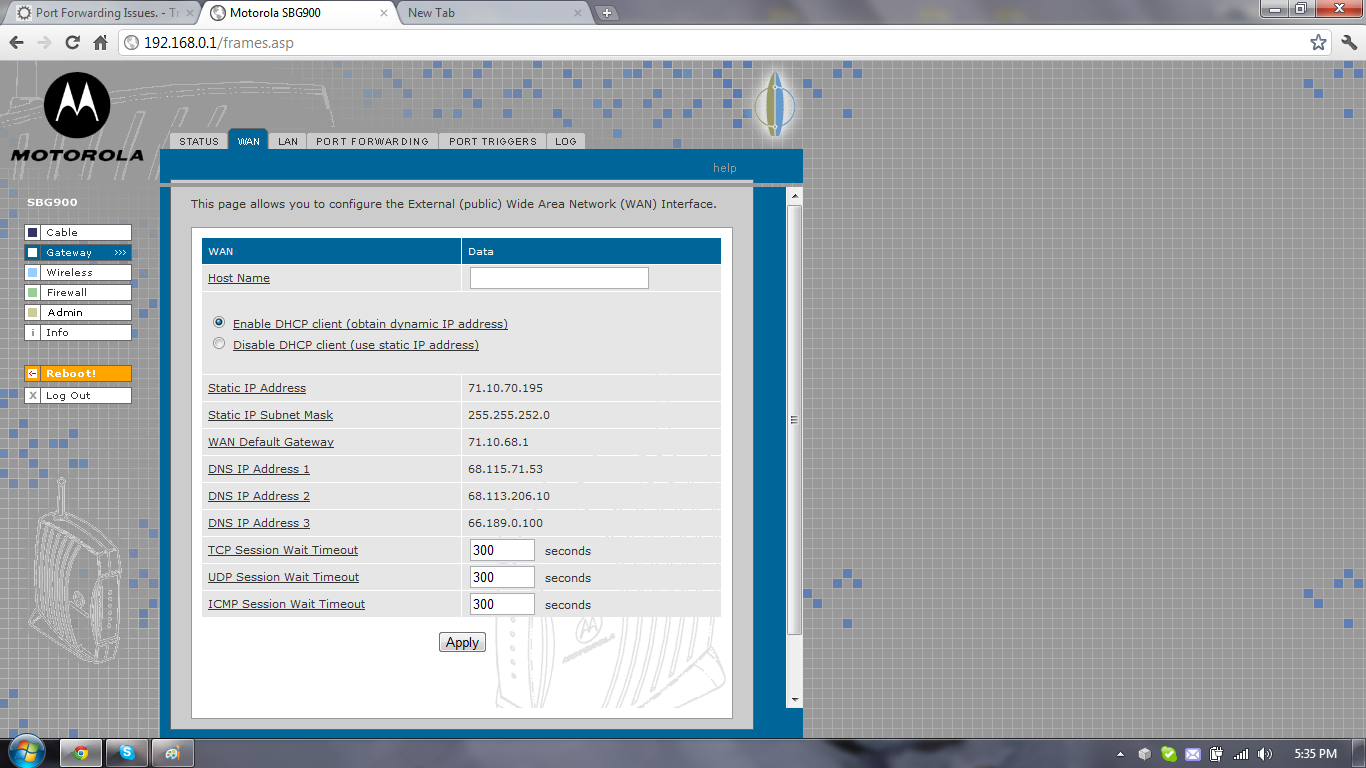

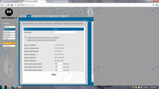

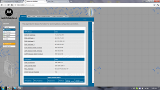

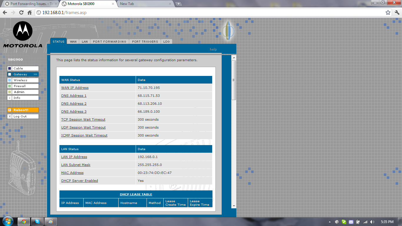

On the second screen - is there anything under DHCP lease table?
It looks like there wants to be. If not, I'm going to have to admit defeat I'm afraid, JT :(

Yes! 4 ip addresses, 3 of which are mine, mother in laws and wifes laptop, one unnamed with the ip of 192.168.0.10
But, that ip won't take me to the vonage interface. :(
Should i just forward the ports to that ip?
