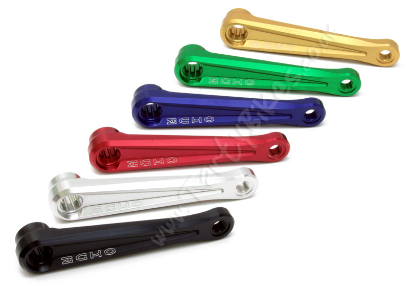

If theyre are these ones:
Then yeah, should do. I have a pair and run a bashring with them, although i use a fixed sprocket not a freewheel...
