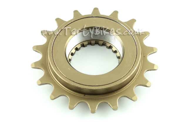

neilrobson1989 Posted April 30, 2011 Report Share Posted April 30, 2011 Hey guys im too embarrased to ask my mate what to do lol its a tensile 18t and i want to put it on the rear hub but i dont know which which side its supposed to face writing facing hub or facing out so you can see it? and do i need to grease it,cheers Quote Link to comment Share on other sites More sharing options...
Miles Mallinson Posted April 30, 2011 Report Share Posted April 30, 2011 Theres only one way you can put a tensile freewheel the side with the splines for the bottom bracket tool goes on the outside, grease it with some lithium grease just a little bit on the threads of the hub and the freewheel. Quote Link to comment Share on other sites More sharing options...

Miles Mallinson Posted May 1, 2011 Report Share Posted May 1, 2011 (edited) Yeh I had to put loctite on mine, mine hasn't skipped at all yet so they are alright on the rear. On the first picture. The black lockring you need to take off but be careful not to disturb any of the pawls, then loctite the threads of the lockring normally leave it for 30mins or so for the loctite to work. On the second picture. You need to grease the threads on the bit that goes onto the hub. Edited May 1, 2011 by Milo123 Quote Link to comment Share on other sites More sharing options...
