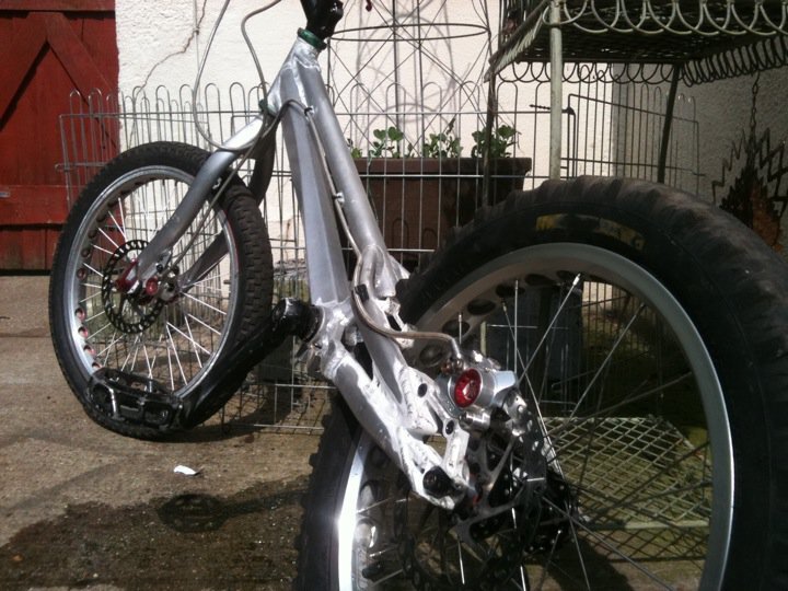

Hey guys, finally gone dual disc! Only got one picture atm but I'll get more later.
Small question though, the brakes are amazing but they pull in at least half way to the bar and feel a little spongy. I've bled them a couple of times and once there was no more air coming out I still did another 2-3 reservoir topups to make sure. Am I just shit at bleeding or is there some underlying problem?
post-26753-0-57516800-1303047593_thumb.j
Found out the reason the brake was still spongy, turns out it was leaking from the banjo bolt, when I went to nip it up a tiny bit the head snapped clean off leaving the threaded end in the caliper. Luckily I manager to turn it out using a screw driver.
The £60 bargin is now looking to be about £100 as it needed pads + adaptor. Now it needs new pads again and a banjo bolt. So pissed off.
