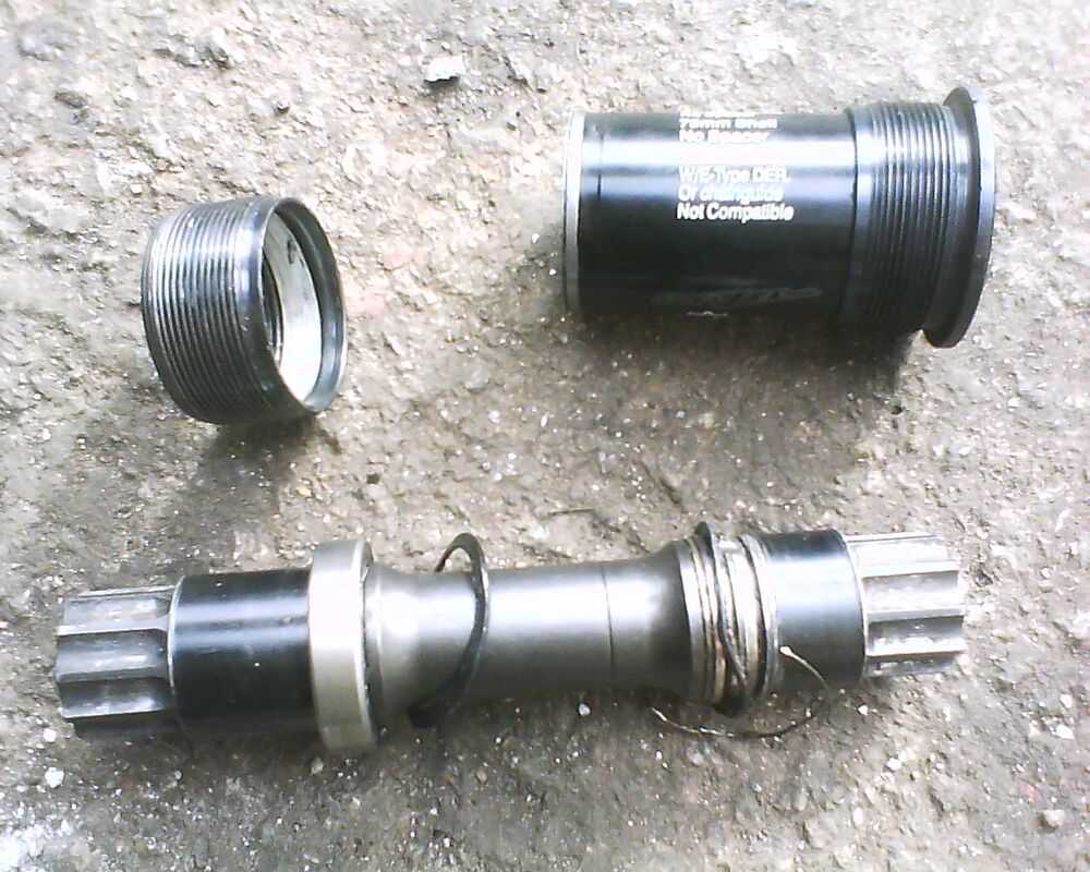

Martin Reynolds Posted April 16, 2011 Report Share Posted April 16, 2011 Well after destroying my bottom bracket today with 5 minutes of riding Anyone else have a problem with onza ISIS bb's? Whats the best way to install a bottom bracket? with grease? dry? with the pre-installed lock tight? I had a problem with mine recently coming loose, which i re-tightened and it came loose again the next day. When i removed the bb, tartybikes had coated the threads in grease, so i cleaned it off and used superglue (did the job, didnt have any lock-tight at the time ) Quote Link to comment Share on other sites More sharing options...
Azarathal Posted April 16, 2011 Report Share Posted April 16, 2011 Clean the splines if secondhand and then locktite, then grease, then install. If new just grease it and leave the factory locktite on there. Quote Link to comment Share on other sites More sharing options...
Martin Reynolds Posted April 16, 2011 Author Report Share Posted April 16, 2011 Clean the splines if secondhand and then locktite, then grease, then install. If new just grease it and leave the factory locktite on there. Isnt that kinda contradictive? using a thread lock AND a lubricant? Quote Link to comment Share on other sites More sharing options...
dann2707 Posted April 16, 2011 Report Share Posted April 16, 2011 I've had my Cheapy onza isis BB for nearly a year now without any problems. My only issue is that it weighs a ton! You should install it with copper anti sieze grease and just tighten it up with the right tool and it shouldn't move. Quote Link to comment Share on other sites More sharing options...
Luke Rainbird Posted April 16, 2011 Report Share Posted April 16, 2011 Isnt that kinda contradictive? using a thread lock AND a lubricant? Sort of. The threadlock will help it to be a snug fit in the frame without coming loose too easily while the grease will help it go in more easily, but often allows you to tighten things better than without it to get a more even fit. Quote Link to comment Share on other sites More sharing options...
Martin Reynolds Posted April 16, 2011 Author Report Share Posted April 16, 2011 I've had my Cheapy onza isis BB for nearly a year now without any problems. My only issue is that it weighs a ton! You should install it with copper anti sieze grease and just tighten it up with the right tool and it shouldn't move. Right, that brings another question up. HOW tight should it be? a foot pound / nm figure would be awesome! Im always afraid to either not tighten it enough and have it screw up the threads, or overtighten it and screw up the threads Quote Link to comment Share on other sites More sharing options...
Shaun H Posted April 17, 2011 Report Share Posted April 17, 2011 (edited) Sounds like your best bet would be getting the BB faced. Torqueing it correctly will help but if you do them up as tight as you dare then a BB generally won't loosen. EDIT: If those are aluminium cups on the bottom bracket then you should use copper grease, although it's of no great concern on a trials bike since most people change frames/cranks etc more often than other cycle disciplines. Edited April 17, 2011 by Shaun H Quote Link to comment Share on other sites More sharing options...
monkeyseemonkeydo Posted April 17, 2011 Report Share Posted April 17, 2011 Sort of. The threadlock will help it to be a snug fit in the frame without coming loose too easily while the grease will help it go in more easily, but often allows you to tighten things better than without it to get a more even fit. I thought he was going for locktite the BB threads and grease the splines... could be wrong though! Quote Link to comment Share on other sites More sharing options...
SamKidney Posted April 17, 2011 Report Share Posted April 17, 2011 my onza Isis bb shat itself within two weeks. Driveside bearings disintegrated. Now running a trialtechs sport bb and have had no issues! Quote Link to comment Share on other sites More sharing options...
