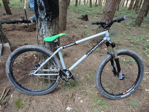

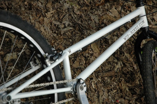

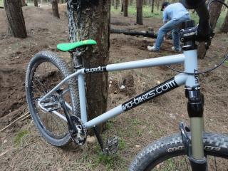

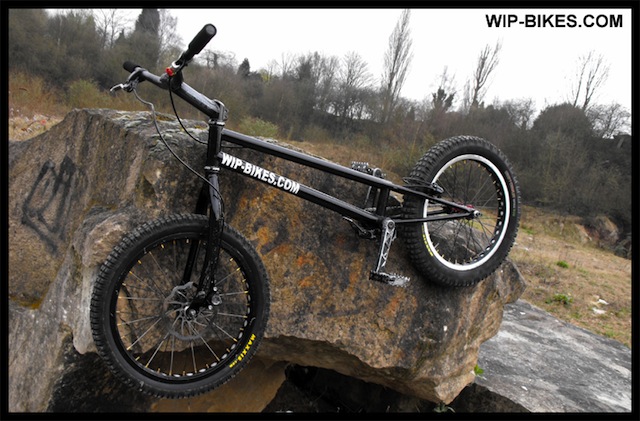

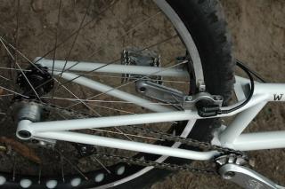

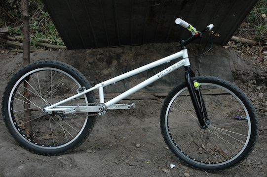

wip-bikes Posted April 15, 2011 Report Share Posted April 15, 2011 And were finally there, design and testing done, just the final few little bits to sort. Sites on its way and shows to attend. What do we think? Quote Link to comment Share on other sites More sharing options...
J.KYDD Posted April 15, 2011 Report Share Posted April 15, 2011 looking really nice man. What sort of weight do the 26's come out at? Quote Link to comment Share on other sites More sharing options...
wip-bikes Posted April 15, 2011 Author Report Share Posted April 15, 2011 Cheers dude. Frame weight is 1.69 kg and my full bikes running around 8.9kg if i recall. I want to get it on a diet though! Then again, its not bad at that, its the lightest bike iv ever had. Quote Link to comment Share on other sites More sharing options...
J.KYDD Posted April 15, 2011 Report Share Posted April 15, 2011 Cheers dude. Frame weight is 1.69 kg and my full bikes running around 8.9kg if i recall. I want to get it on a diet though! Then again, its not bad at that, its the lightest bike iv ever had. For a steel frame thats awesome! Are they custom geo's or are you producing set batches? Quote Link to comment Share on other sites More sharing options...
wip-bikes Posted April 15, 2011 Author Report Share Posted April 15, 2011 Its dammmm stiff to! The rear brake is the best bit! Yes and yes, i have 2 sizes in all the models and also do custom models. Are you going to any events this year? Quote Link to comment Share on other sites More sharing options...
