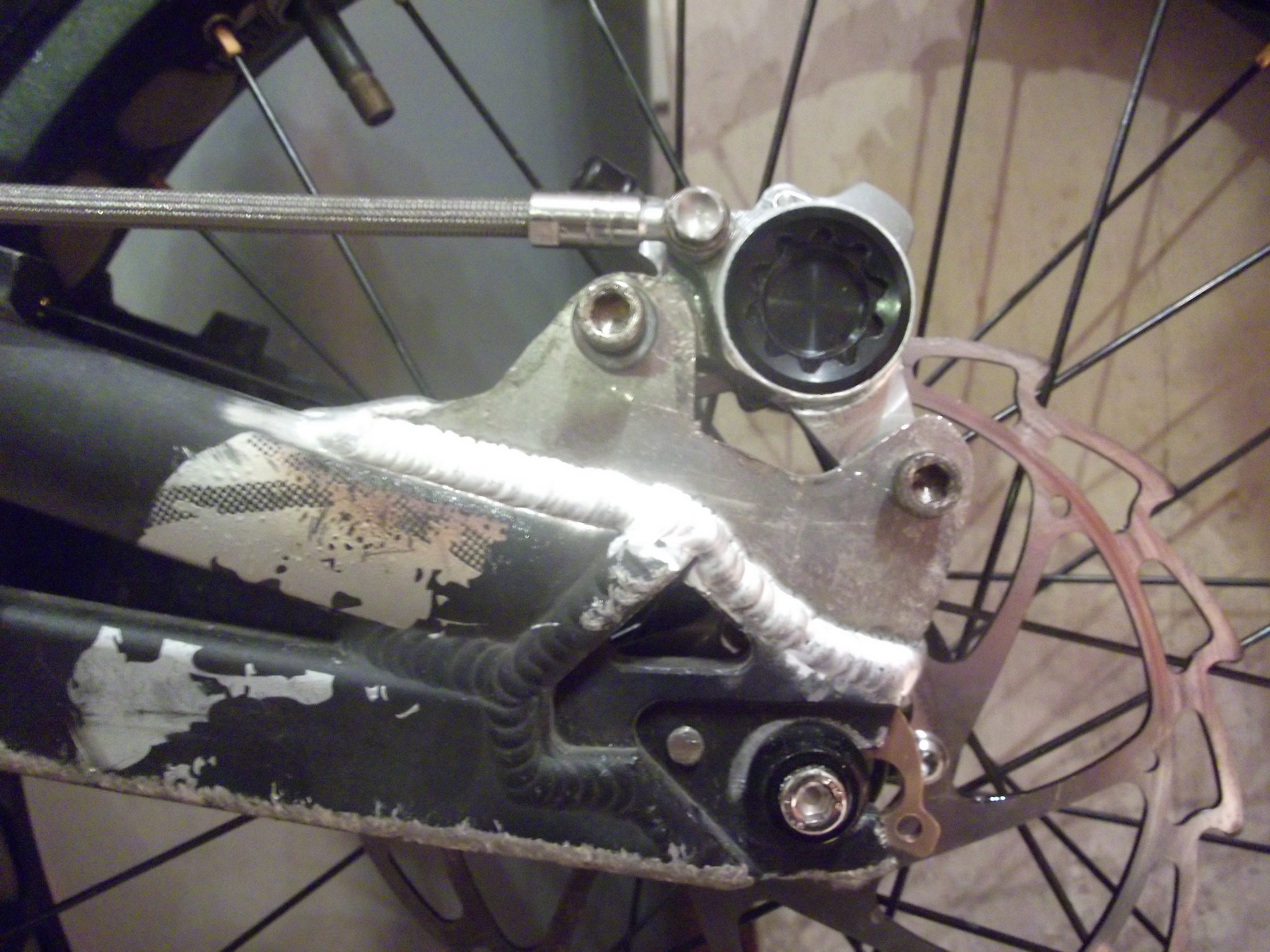

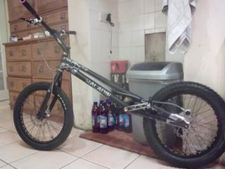

dirt jumper jake Posted April 4, 2011 Report Share Posted April 4, 2011 Picked up the maladie from the welders today, and im bloody chuffed. Looks mint, caliper is aligned perfectly and uses a 80% of the pad atleast so im happy with that too. Spec is: Frame:Maladie frame Disc () and maggie mounts Forks:Echo SL forks Stem:Onza T-master stem Bars:Rockman 7046 bars Headset:Chrisking Front wheel: Rockman Disc hub & Atomz Elitis Rim Front Tyre: Kenda SB8 20x2.1 Cranks: Monty kamal 158 Freewheel: Echo TR BB: Reset Ti ISIS Pedals: Echo TR Chain: KMC 710 Backwheel: Rockman Disc hub/Echo Ti sprocket/Echo Ti cams & Atomz Elitis Rim Back Tyre: Tryall stiky Brakes: Hope Tech Trial + Alligator rotors Feel free to poo-poo as you lot usually do... Quote Link to comment Share on other sites More sharing options...
LukasMcNeal Posted April 4, 2011 Report Share Posted April 4, 2011 If you moved the bolt for the caliper nearest to the axle down abit by drilling a new hole/slot I think you could easily improve that mate. Other than that it looks pretty solid, nice one mate Quote Link to comment Share on other sites More sharing options...
Mission Impossible Posted April 4, 2011 Report Share Posted April 4, 2011 looking good,do you think you will spray the bit where the paint has rubbed of Quote Link to comment Share on other sites More sharing options...
dirt jumper jake Posted April 4, 2011 Author Report Share Posted April 4, 2011 If you moved the bolt for the caliper nearest to the axle down abit by drilling a new hole/slot I think you could easily improve that mate. Other than that it looks pretty solid, nice one mate Yeah im gonna file the hole out a bit to see if i can get it slightly better, but yeah cheers looking good,do you think you will spray the bit where the paint has rubbed of Cheers and i thought about having it re anodised, but am worried about it ruining the BB threads Quote Link to comment Share on other sites More sharing options...
Mark W Posted April 4, 2011 Report Share Posted April 4, 2011 Might be worth seeing if the disc mount's holding up before anodising it too. If it works then cool, go for it - if it doesn't work, you haven't spent £XX anodising a frame that's dead. 1 Quote Link to comment Share on other sites More sharing options...
ireson75 Posted April 5, 2011 Report Share Posted April 5, 2011 Looks really good mate, the weld looks well done Quote Link to comment Share on other sites More sharing options...
AJ9604 Posted April 5, 2011 Report Share Posted April 5, 2011 looking good fella Quote Link to comment Share on other sites More sharing options...
dirt jumper jake Posted April 5, 2011 Author Report Share Posted April 5, 2011 (edited) Might be worth seeing if the disc mount's holding up before anodising it too. If it works then cool, go for it - if it doesn't work, you haven't spent £XX anodising a frame that's dead. Yeah that was the plan dude, also, will the olives on tarty you sell go on hope braided hosing? Edited April 5, 2011 by dirt jumper jake Quote Link to comment Share on other sites More sharing options...

Luke Rainbird Posted April 5, 2011 Report Share Posted April 5, 2011 Cool stuff. Getting that mount moved slightly would be the icing though, wouldn't it... Quote Link to comment Share on other sites More sharing options...
dirt jumper jake Posted April 5, 2011 Author Report Share Posted April 5, 2011 Great to see mods done to mods Hope it holds out for you fella Cheers dude Cool stuff. Getting that mount moved slightly would be the icing though, wouldn't it... Yeah it would, i need to get the brake bled and see how well it actually holds/works, if i think it can be better i will have another little play, but i dont want to ruin it now its done Quote Link to comment Share on other sites More sharing options...
